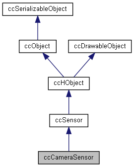

Inheritance diagram for ccCameraSensor:

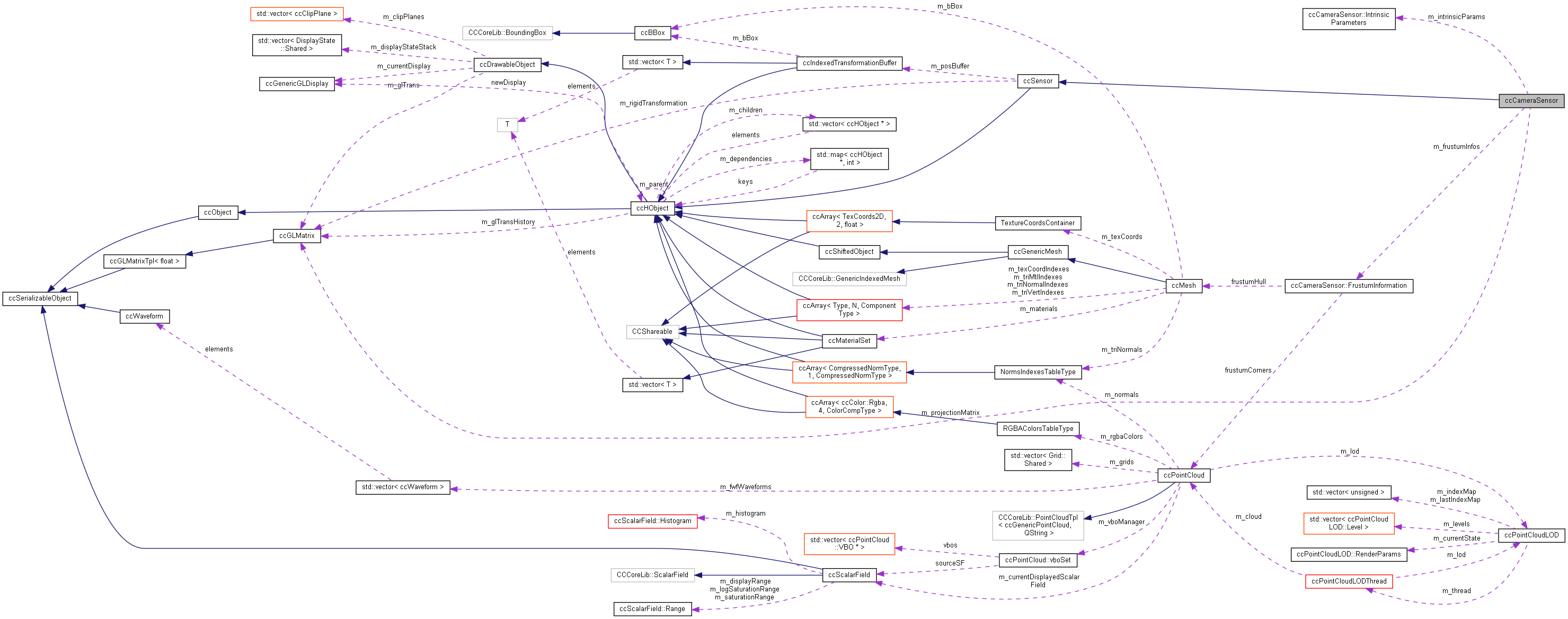

Collaboration diagram for ccCameraSensor:
