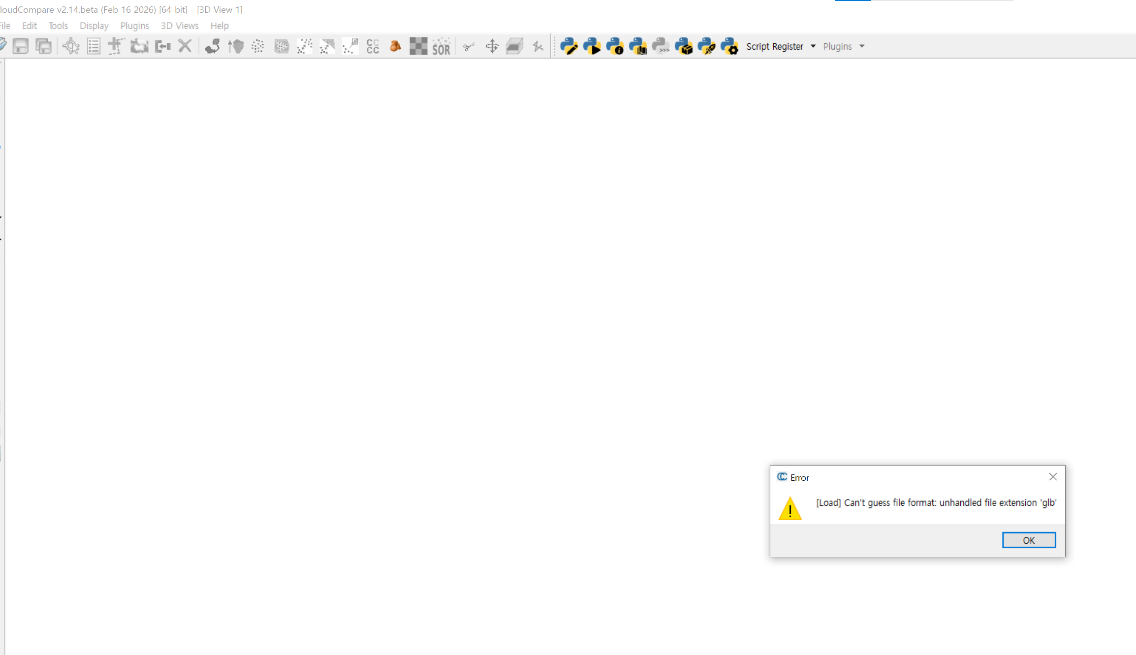

after 2.14 beta update,
CC can't read .glb file.
Please handle this issue. Thanks a lot.
issue abot .glb file.

But previous version can open .glb file.
glb issue.png (33.33 KiB) Viewed 9834 times

Ah, it must have been managed by the Mesh I/O plugin then. This plugin was not compiling with Qt 6 anymore, but I managed to fix it I think (I haven't been able to test).
Posts: 8158
Re: 2.14 beta can't read .glb file.
Can you test this new version: https://www.cloudcompare.org/release/Cl ... up_x64.exe
(sadly it's not signed with a certificate, so you may have to convince Windows that it's safe to run)
Post by Jay_Ki »
It works. Thanks a lot. :)
