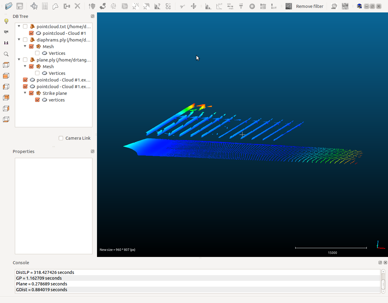

I had been reading the forum and came to know that the CLOUDCLOUD_DIST fits the local plane to get the distances using the nearest neighbor approach. I am assuming in my case this would result in the vertical distances only ?
I have attached a screen shots of my processed data, if you look at it, there are two point clouds (one for the bridge girders and the second one for the sub structure).
Screenshot attached
Screenshot attached
For the sub structure on the sides you can see that distances are more (scalar fields greens and red) as when compared to the cloud directly below the sub structure, so is this calculating the shortest distance ?
