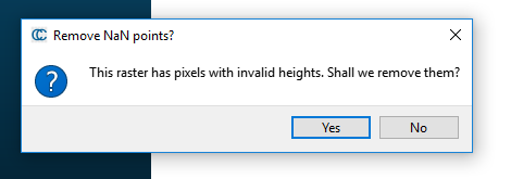

Just wanted to suggest that a "yes to all" button be added for this:
Invalid elevations.PNG (8.22 KiB) Viewed 20453 times
Additionally, it may be useful to modify the yes to all for the coordinate translate/rescale. Having some logic in it to automatically rescale all the added points instead of asking again about the translate/rescale when the point in local coordinate system gets too large would save time. This would save time when loading point clouds that cover hundreds of kilometers.

Ok I added the "Yes to All" button to the invalid raster pixels (it will be available in the 2.10.2 version soon).
For the other one, can you be more explicit? What kind of logic are you expecting?
