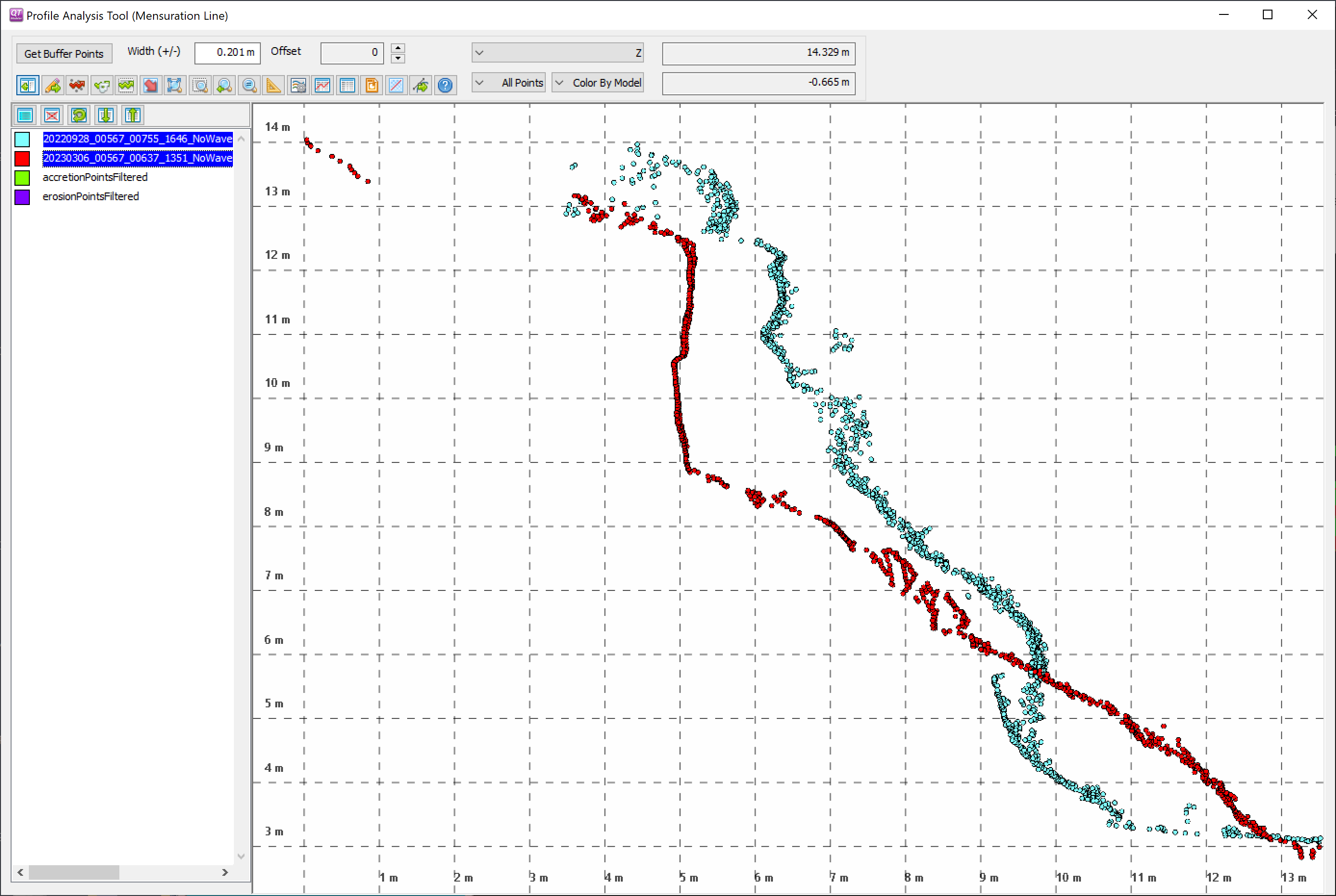

We have LiDAR point cloud of pre and post rockfall clouds that look like this: (light blue being the pre-event surface, red being the post-event)

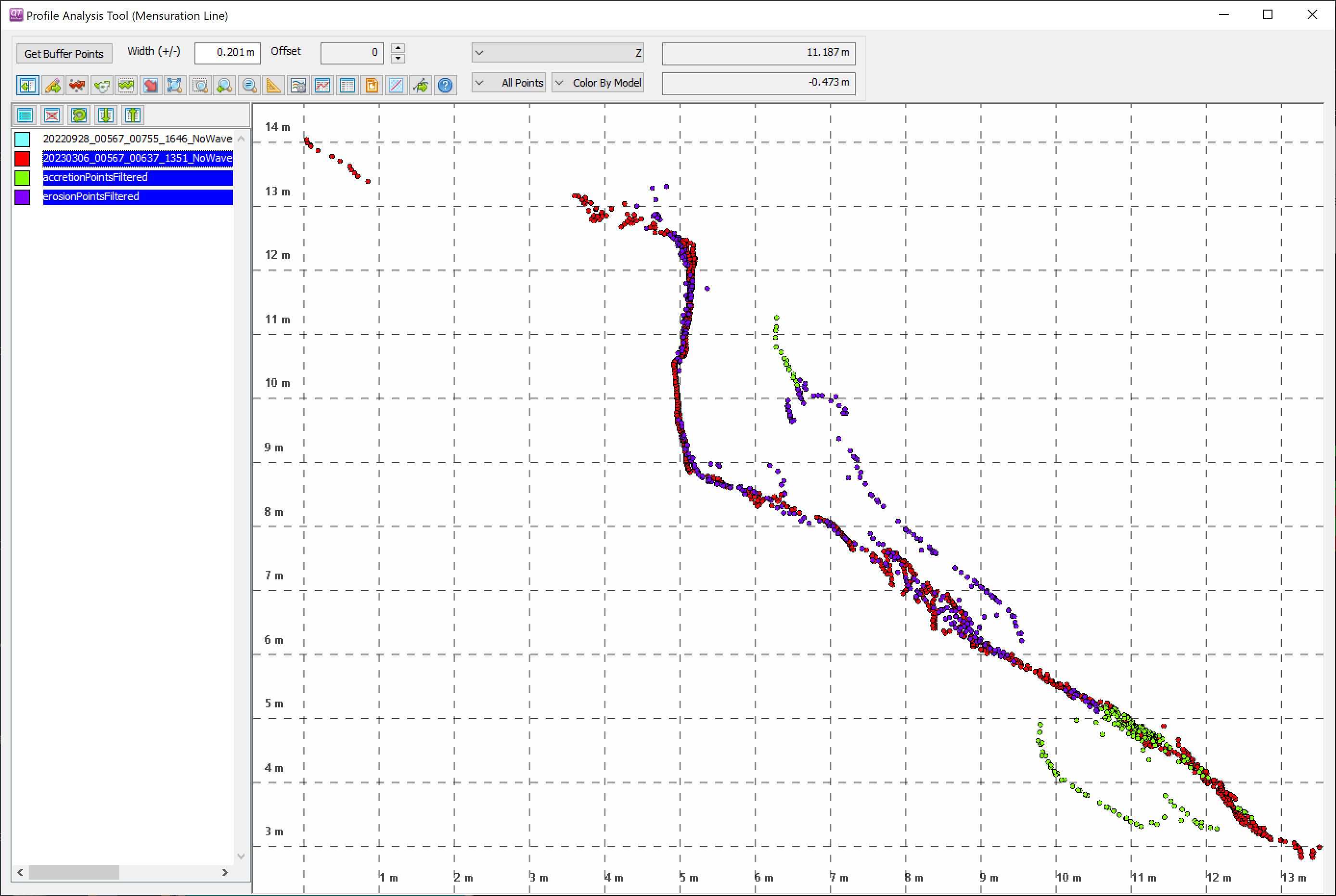

Purple points are identified as part erosion events while green are accretion events. My question is about an odd batch of green points between meters 6 and 7 10.5 meters up the surface, better seen here:
These points should be part of the erosion cluster but have been flagged as accretion for some reason and I'm not sure why. I'm assuming the parameters need to be adjusted, it looks like D might be better chosen at 1 or .5 meters to capture the roughness of the cliff in that area, but I was wondering if anyone had any thoughts on this. The whole top section of the light blue cloud is also being omitted from the M3C2 results which is problematic for volume computations later on.
Maybe I would be better off running M3C2 in the same direction but projecting onto cloud 1 first, then onto cloud 2 to get the desired 3D cluster of points with significant change? It seems like the difference in surface normals between the two clouds might be another culprit behind these results.
There is also a small batch of purple erosion points between 10-11 m on the x and 5-6 m on the y that should be accretion instead. Any thoughts on how to optimize the parameters to improve these results would be much appreciated. Cheers!

Hi Daniel, thanks for your response - I'm not sure how best to display the normal for inspection, I know there is a 'toggle normals' option when I right click on a cloud though this doesn't display them as a vector so it is hard to tell. I also updated the "preferred direction" argument to be -X instead of -Z which improved the output significantly, but I'd love to be able to see the normals to make sure, is there a way you recommend displaying them? I have the Nx Ny Nz values but I'm not sure how to project them onto the cloud or if that is possible within cloud compare? Are you able to get a sense based on the profiles for a better set of parameters to pass? I tried again with D =.5, d=.25 and L=5 which seemed to perform slightly better (although it could have been improved simply because of the -X argument). I'll send along the clouds and parameter file via email, thanks for being willing to take a look at it, let me know if you see any obvious tweaks that should be made in parameter choices.

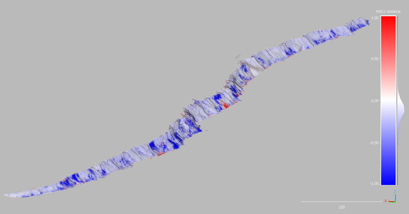

Here is the result:
Since the average distance is 0.18m, I wonder if the registration between the 2 clouds is very good? Maybe it would make sens to refine it first (with ICP for instance).
