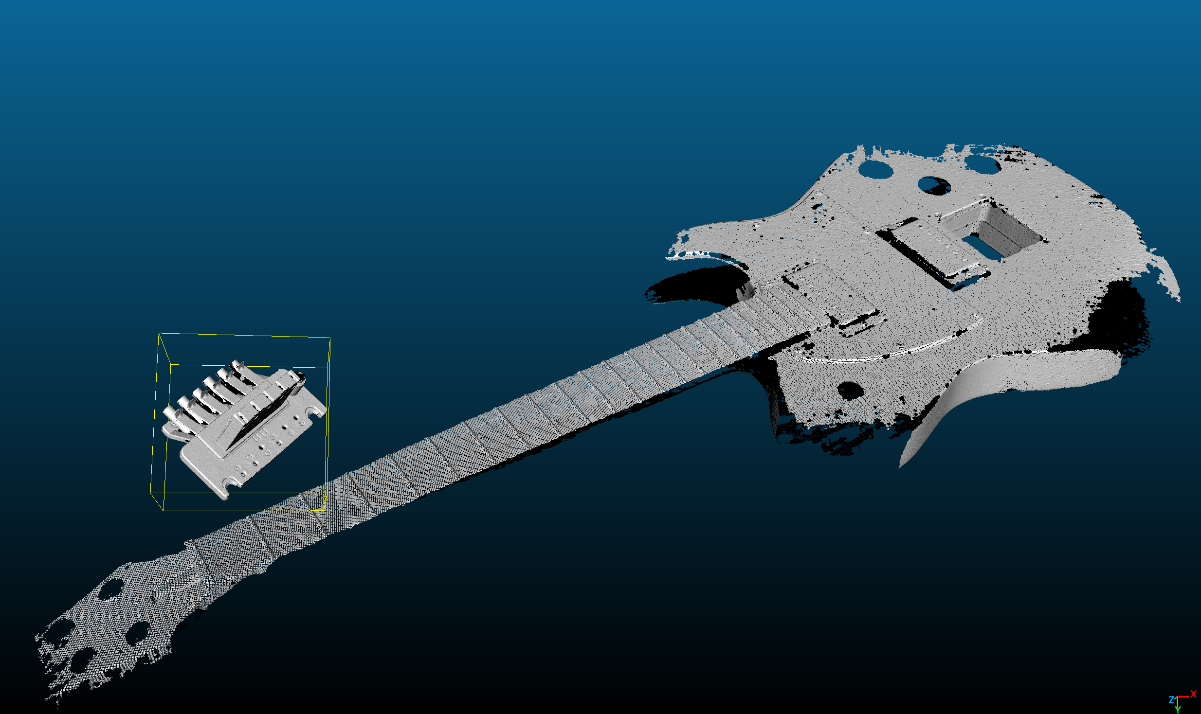

Here is a screen shot of what I am trying to do.
There is a point could scan of a guitar and a scan of the guitar bridge (in the yellow box).
Screenshot 2025-04-15 at 10.45.32 PM.png (1010.75 KiB) Viewed 12105 times
Is it possible to move the bridge in the correct place on the guitar?
Thanks.

Well, yes, but mostly manually. Use the 'Edit > Translate/rotate' tool.
See https://www.cloudcompare.org/doc/wiki/i ... ation_Tool
I don't think registration/alignement tools will be very useful (apart maybe for the point pair picking tool... see https://www.cloudcompare.org/doc/wiki/i ... gistration)

Yeah, I’ve done something similar with CloudCompare when working on scanned mechanical parts. You can definitely move and rotate separate pieces, but it’s a bit clunky. I had to import each part individually, then use the Translate/Rotate tool (it’s that little cube with arrows) to position everything. Just make sure you're selecting the right part in the DB Tree before adjusting it, took me a few tries to get used to that. It’s not the smoothest workflow, but it gets the job done.
