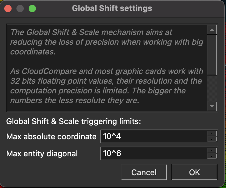

I just discovered the Global Shift Settings and read through the description in this box.
Screenshot 2026-01-20 at 11.13.38 PM.png (105.72 KiB) Viewed 24471 times
It is my understanding that Cloud Compare is used a lot for large clouds, such as landscapes.
Since I will only be using it for 3D scans of guitars, what would the the ideal Global Shift settings for my size range?
Thank you very much.
Posts: 8247
Re: Global Shift Settings for Guitar Scan Sizes
If it's mm scans, with coordinates not too far from zero, then you can probably ignore the Global Shift and keep the coordinates as they are!
