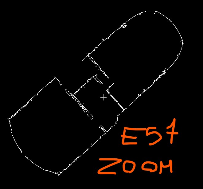

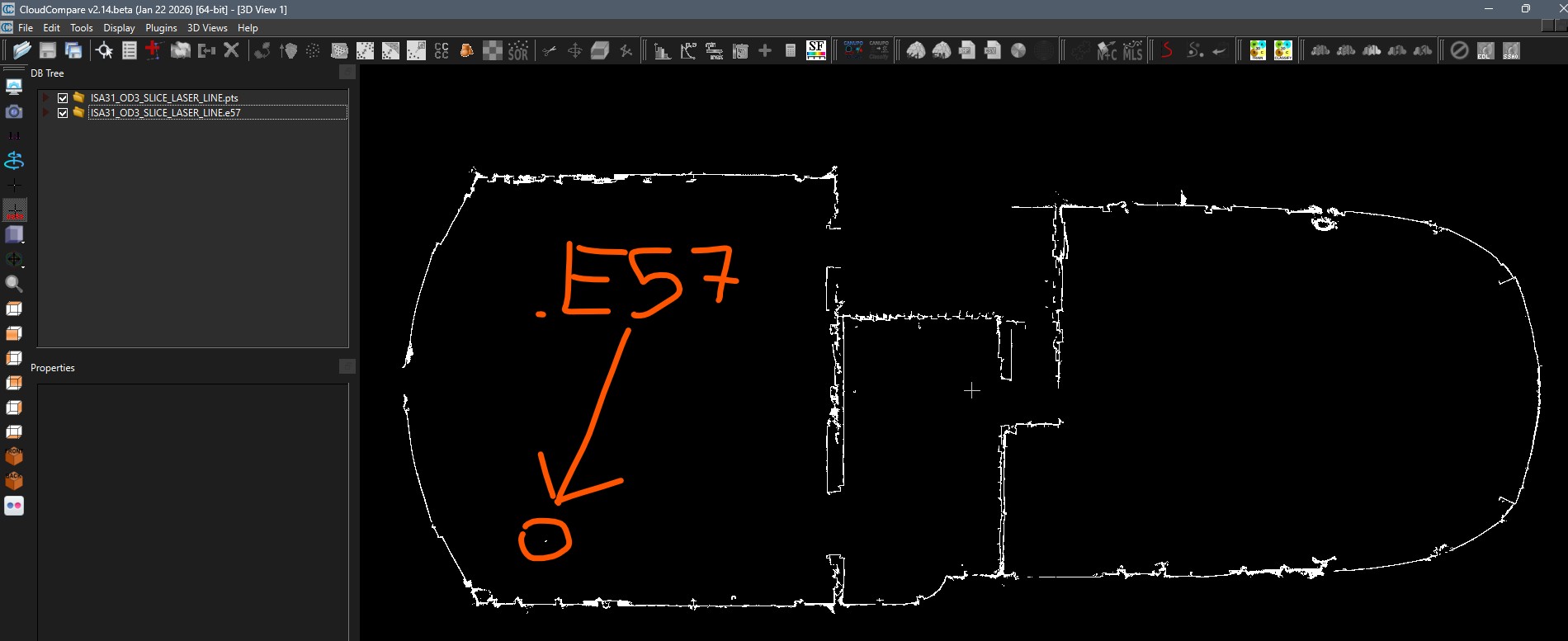

Uhm, scale and orientation issue still there.
Wrong scale is not a big deal anyway. easy fix
Orientation is critical
I clicked NO on both imports when asked to apply global transformations
Also tryied clicking YES at everything, resulting in .e57 point cloud traslated and nothing else.
- 2.jpg (37.97 KiB) Viewed 66093 times
- 1.jpg (135.39 KiB) Viewed 66093 times

Workflow:
bigger point clound inside a standard, cc's .bin file.
Used X tool to slice it up, to export only the tiny slice into other software for development.
At this point i had to chose point cloud format for the other sw. it can be either .e57, las/laz OR plain ascii .pts
Decided to go with .e57
Saved slice (from cc) in .e57. Opened in other SW, noticed the misalignment.
Saved slice (from cc) in .pts. Opened in other SW, noticed everything is OK.
Opened again both files in cc shows same behaviour.
Where is the issue?
Here: I saved a point clound from cc in .e57 format and i lost original position and alignment.
saving it in .pts format is OK
