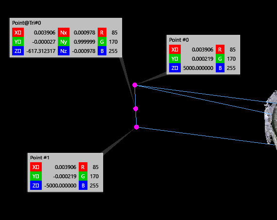

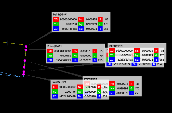

I assume that small errors in a strictly defined plane, where the Y is set to 0, and normal is pointing in integer direction, are related to the "gl" graphical mechanism in which the entities are "filtered" into. is it right?
Units in that file are to be considered in millimeters
note:
i noticed that points that are not vertices (or are they?) can be picked in the shortes edge of my plane.
Posts: 8247
Re: Point Picking on Wireframe Planes
Hum, strange, but not impossible (especially because I had to 'project' the picked points on the nearest edge). I'll have to look into that.
