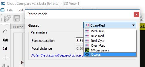

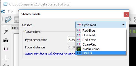

Re: Label moving
Posted: Fri Dec 02, 2016 11:21 am
by Steve L~
Ah, Have I mixed up my installations?
Can they co-exist on the same machine if installed in different directories?
Non stereo version: [img]
[/img]
stereo version:[img]
[/img]
Re: Label moving
Posted: Fri Dec 02, 2016 12:23 pm
Can't remember but you'll probably have an error message if you try to use the Oculus mode if you use the non 'Stereo' version.
