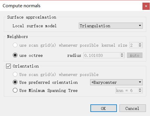

Hi, Daniel
When I use tools to computer cylinder cloud normal, the result shows successful.I set parameter like this which is show in picture.
.Unfortunately, when I compile from source file,the result of the normal compute show not successful.I have tried 2.8.0、2.8.1 and 2.9.0 version source file, could you please tell me the reason?
