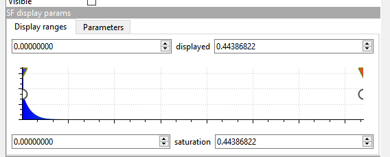

I had a crack at it and had difficulty achieving what i was attempting to generate.
I computed the curvature and then had a look at what areas were what curvature, checking to see whether distinct man made features or sharp features were either above or bellow a set curvature. However when you then go to do the sub sampling it is a relationship between the maximum curvature value and the minimum curvature value and two set sub-sampling distances.
What would be incredibly useful would be to set the curvature value, e.g. no sub-sampling on any points above a certain value of curvature. Or simply have it as a binary, sub sample when the curvature is equal to or less than a cutoff value and leave any points above that curvature as is. This is really pronounced in the data i'm looking at as the histogram of the scalar field looks like this:
topo curvature scalar.PNG (7.32 KiB) Viewed 32776 times
kind regards,
Andrew
Re: Thinning ground survey
Posted: Fri Feb 01, 2019 9:39 am
For this you can use the 'Edit > SF > Filter by value' tool to split the cloud. Then use the subsampling tool only on one part. And then merge the result with the other part of the cloud.
And of course you may want to use another scalar field than the curvature.
