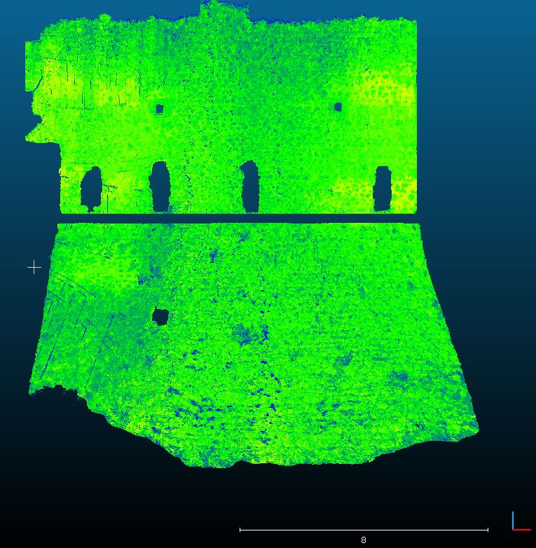

For the records, thanks to Andrea's files I was able to fix/improve the unroll tool. This is available in the latest 2.11.alpha version.
One can now set the angular range of the unroll tool for all modes (i.e. also the conical projections).
Otherwise, the former 'straightened cone' mode has now two flavors (with 'fixed radius' as before, or with a corrected radius based on the theoretical cone shape).
Here's the result:
P.S.: mind that the unrolled clouds are not at the same height because the 'cylinder unrolling' method uses the Z altitude directly, while the 'cone unrolling' method uses the curvilinear abscissa (starting from the cone apex). It's easy to manually reposition the unrolled cone if necessary.
