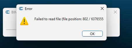

Same, November beta ver can not open BIN saved by stable v2.13.2 (utm pc)
Screenshot 2025-11-15 173437.png (14.49 KiB) Viewed 61585 times

Re: Nov beta can not open BIN saved by Sep version
Posted: Sun Nov 16, 2025 8:51 am
Hum, looks more like a corrupted file than anything else... I haven't been able to reproduce the issue on my side sadly.
Did you use the official 2.13.2 version on Windows?
And was it just a simple point cloud inside this file? Maybe with a color scale that has labels? If yes, do you still have the same issue if you remove the color scale and save the file again?

It not corrupted file
I can reproduce it many of times
The attached file can be opened by v2.13.2 but not November beta
Posted: Sun Nov 16, 2025 7:54 pm
Ok, it seems to impact files that have VLRs meta-data (so with a point loaded from a LAS file).
I've patched the Windows version online (16 Nov.) so as to skip the loading of this particular type of meta-data until we find a fix.
