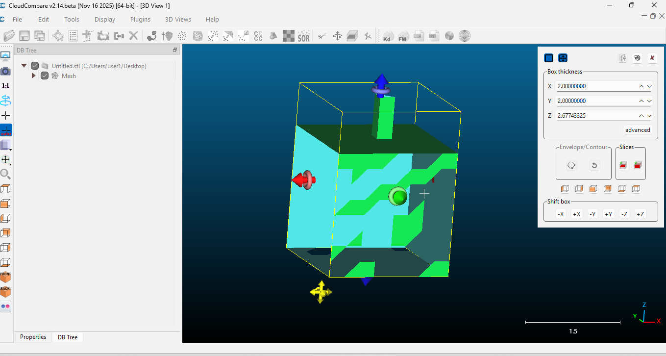

I propose to set startup default box thickness of section tools to (101)% of object dimension to avoid the case of attached file
if you select mesh then open section tools and do not change any value mesh loses some vertices
but if you select mesh vertices then open section tools and do not change any value no vertices are lost
it is cube 2x2x2
Screenshot 2025-11-21 082056.png (95.08 KiB) Viewed 89199 times
2x2x2.zip
(8.25 KiB) Downloaded 3367 times

To explain this issue, It is not about visual cut during display in section tools, but about the result after section
