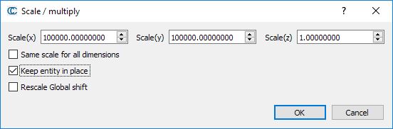

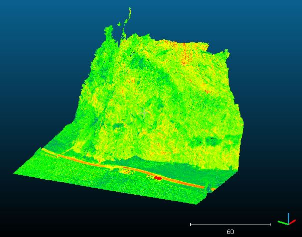

Not sure to understand what you mean by '2D' object. Did you apply the scale the right way?
Here are my parameters:
And here is the result:
However I strongly advise you to find the solution on Agisoft's side, otherwise you'll lose a lot of precision by working this way ;)
