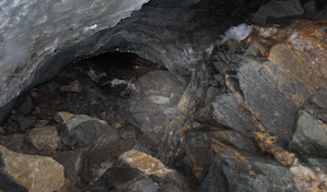

I have a ~500 m long cylinder and I am studying the inside of it. I have digitized it into about 20 models with overlap.
All un-scaled, un-oriented, etc. An example segment can be seen here:
