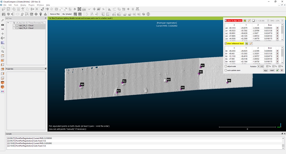

hI looked at the scans and it's clearly visible that there are high shifts between the scans. As the displacement is huge (> 0.05), rigid (the wall scan is not distorted but simply shifted as a whole) and it happens at various epochs, I really think the scanner has moved.
From my point of view It's totally valid to register the scans as they are clearly shifted (and not distorted).
But considering that the clouds are wide and very flat, ICP (Fine Registration) can't work properly. You'll have to first use the 'Point pair based' registration tool (Align). Use the various corners and features that are clearly recognizable on both clouds. And use a lot of pairs, and spread them all over the clouds if possible (even though here they are mostly aligned in the central area sadly):
Then you can use ICP with a low overlap ratio (e.g. 60%) and a small RMS difference (e.g. 1.0e-6).
Of course it's a very manual process, but it's the best you can do without physical targets...

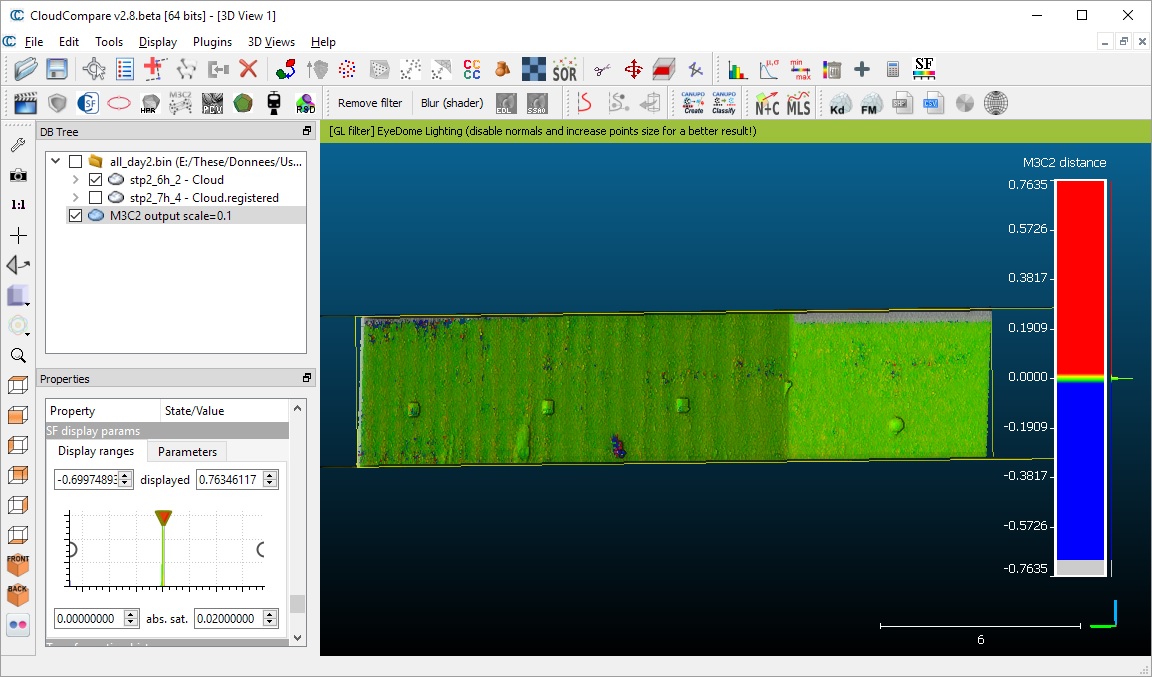

Here is what I get between 6h and 7h:
It's much better than the original positioning. And you still get the 'wave' effect even if it's quite small between these two clouds. I haven't tested the others.

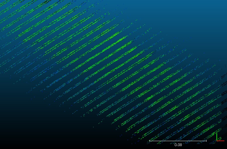

P.S.: Not sure if I already mentioned this, but I find the clouds pattern a little odd (here is the cloud 11h when looked with a high zoom and from the top):
Have you applied any process before exporting the clouds from Cyclone?
