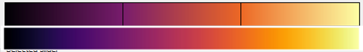

Last change, I swear. This modified version solved daniel's concerns. You can now select the number of segments you want to use. For instance, using 4 segments as below gets a near-perfect approximation of inferno. You can adjust more/less segments as needed for balance between performance/perfection.

You can see the resulting color scale in the attached image:
And a comparison with the color scale on top and the original below. You can see it's close, but not perfect. Again, a few more segments would drastically improve the appearance:
Re: Color : better default color scale
Nice!
