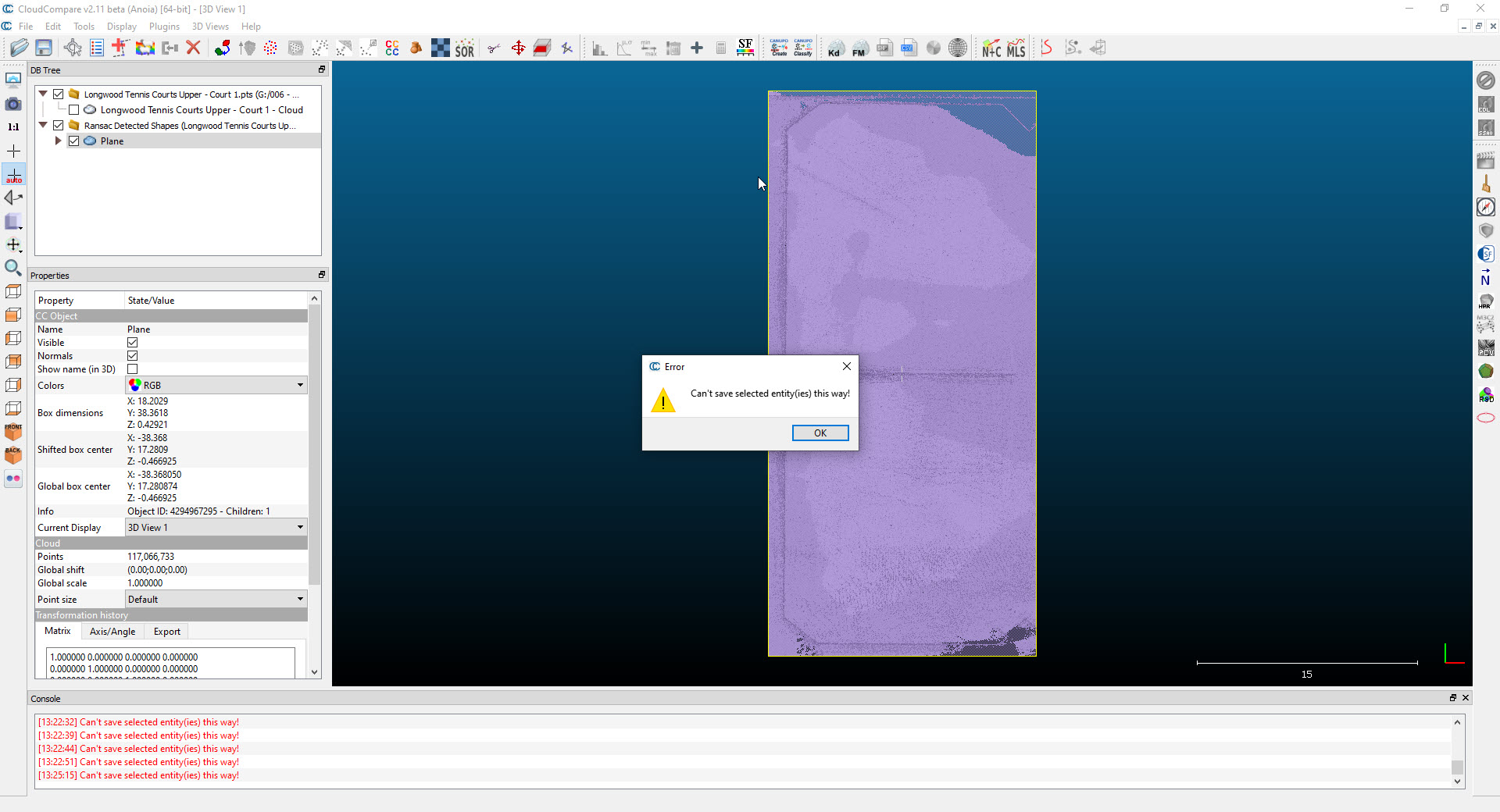

Here is a screen snap of it.
saving error.jpg (342.49 KiB) Viewed 19390 times
Re: Saving Error
Can you send me any of these files? (admin [at] cloudcompare.org)

Re: Saving Error
Thanks for the file. And... I tested it and didn't experience any issue (with the 2.11 version). That's probably related to something else but I'm not sure what ?!
