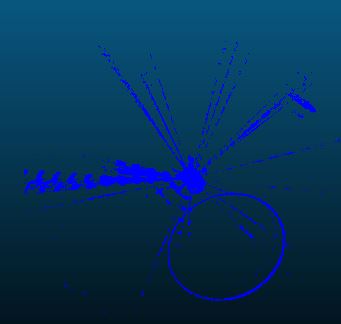

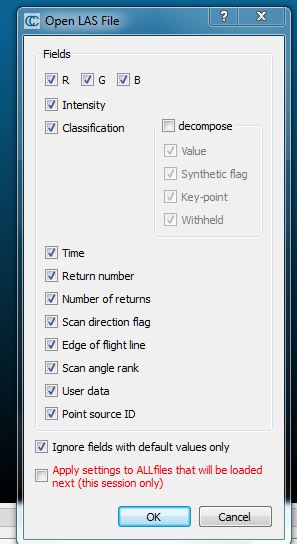

I have a las file of very big size. I save it in two formates and have following difficulties.
* las
if I save a small part of it it as las and read it again, I 'm getting a single value of intensity which is not real one. please see attachment.
Note: with last version of CC , I was not facing this issue.

- result
- las_2.JPG (14.1 KiB) Viewed 13696 times
- reading file
- las_1.JPG (35.08 KiB) Viewed 13696 times

For the LAS issue, I can't reproduce the issue. Are you sure that each time you are displaying the 'Intensity' scalar field? Is there warning messages in the console that might explain this issue maybe (not enough memory, etc.)?

For the 1st point: I do use the last version myself. And I can't reproduce this issue. Can you share your file with me maybe (at least the small part)?
