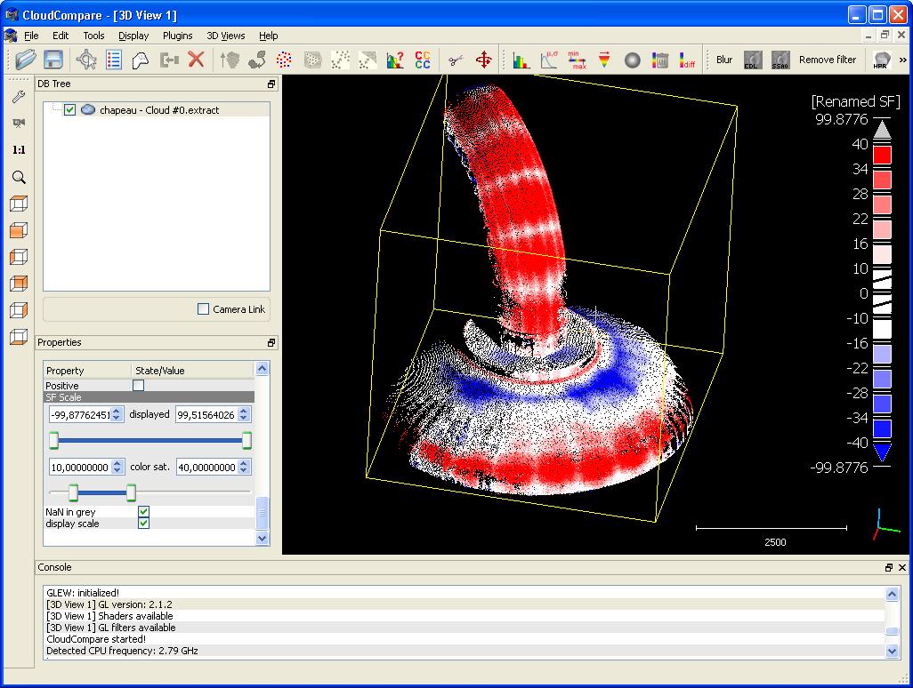

here is a first peak on the new 'color scale' system.
- I've found very neat widgets to handle intervales (Qxt library 'SpanSlider' - libqxt.org). It should help to better understand how the sliders work.
- I've added options in the 'Display settings' dialog to handle the color scale display and behavior (squares size, text size, 'always display 0', and 'always symmetrical' - this last one is forced for the moment as I didn't had the time to change this last point - the new release will come out as soon as this is ready)
- there's a new color ramp named 'Blue>White>Red' as you suggested (I juste kept the convention: blue for minus (cold) values and red for positive (hot) values)
- as the color scale is not always linear, I've added a new type of square (a slashed one) to indicate the ones that have not the same span as the others
In this new version of CloudCompare you'll also be able to rename de scalar field. I'll try also to make CC rembember the SF name when the cloud is saved as a 'bin' file.
EDIT 09-04-2011: the last version is out. You'll find everything you need in it!

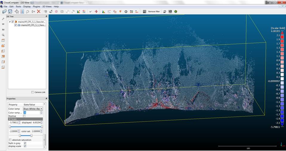

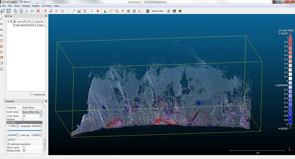

Re: Issue with displaying negative scalars
excellent. Thanks for the great update.
Minor issues :
. There seems to be an issue with the symmetry of the color scale when the absolute saturation is on (visible for the blue-white-red color ramp). Here you can note that the white scalars correpond to 0/0.1 and 0.1/0.2 while it should be -0.1/0 and 0/0.1. Also there's sometimes rounding issues (not all the times !). This symmetry issue is still there even if the color saturation starts above 0.
Finally, it's not that important, but when the absolute saturation is on, the minimum and maximum in the scale are identical. Any chance the minimum and maximum could actually be the true one (for the example above -5.798 rather than -6.00025) ?
Hum,
didn't you want to work in non-absolute mode? In this mode, the minimum and maximum are actually the true values.
For the other issues, the color in each square is generally the color that you would get with the average value in this square. But for some specific values (0, min and max, etc.), the square has the corresponding color. It might explain this behavior. I'll look into it to sort this out.
true : in non absolute mode, you have the correct min and max, and I can manage to have the white centered around 0 (but you have to play with the number of intervals and choosing well the min and max color saturation), but I still have some rounding errors :
