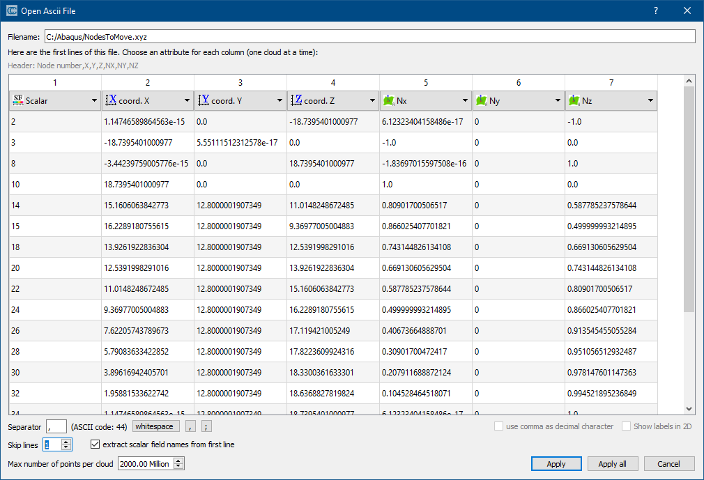

I'm importing a point cloud from a text file that I generated myself. The points lie on a perfect cylinder with its axis aligned with the global Y-axis. As such, if I understand things correctly, all points should have a normal with a zero y-component. This shows the Ascii file import window with all Ny values zero.
Ascii file.png (53.02 KiB) Viewed 2179 times

Nope, that's 'normal'. It's because normals are compressed to save memory (they are replaced by the nearest orientation from a list of orientations regularly sampled on a sphere). Hopefully the resulting angular error should be quite small.
