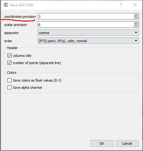

Unfortunately I have not yet found a satisfactory answer to my problem in the forum. I received a point cloud from third-party software, the coordinates have a total of eight decimal places. The software with which I have to visualize this point cloud cannot process this. Is there a way to export the point cloud with fewer decimal places? I think I had seen such an export setting somewhere, but I can't find it anymore.

You can set the decimal precision when saving as an "ASCII cloud (*.txt *.asc *.neu *.xyz *.pts *.csv)"
