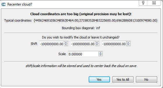

I've got a problem opening a bin file I've been working on for a while - it tells me opening that a cloud co-ordinate is too big, but no matter what options I seem to select it crashes out after the dialogue box as the attached image. Everything was fine before a crash when meshing a cloud, on re-opening the last saved file I got this problem.
No problem (I thought) as I regularly incrementally save the bin file with a new name.... but I've discovered that trying to open any of these crashes out too (no dialogue box, just a straight crash).
The bin file is about 28Mb - has it got too large? Any ideas for recovering my work...?
Thanks (in hope!)
Steve

Very strange indeed! Can you send me the BIN file?

Hi Daniel, Thanks for getting back to me. The file is about 30Mb... I can upload to our GDRIVE depository if you can mail or PM me an address...

Thanks for looking into this, I can confirm that the new 'Christmas' Release 2.5.2 solves the issue of a corrupt mesh.
The problem mesh has been re-moved and the remaining vertices etc. have been moved into a "Orphans" group - the rest of the file is intact.
Thanks for the release, looking forward to trying the new features...
