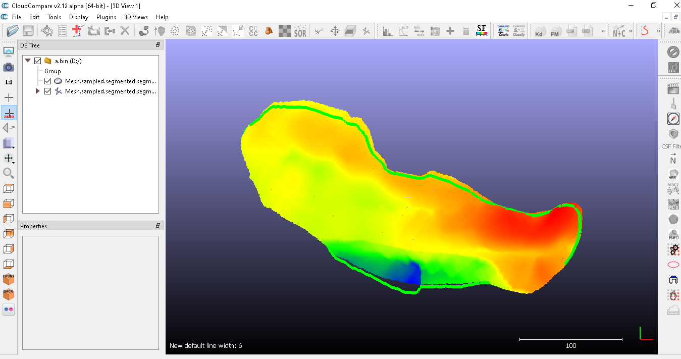

I tried every thing but no luck because perimeter points has different z level .
Fortunately , my cloud points are always dense (generated by mesh sample points) this why I think it is not default to find perimeter point with some algorithm

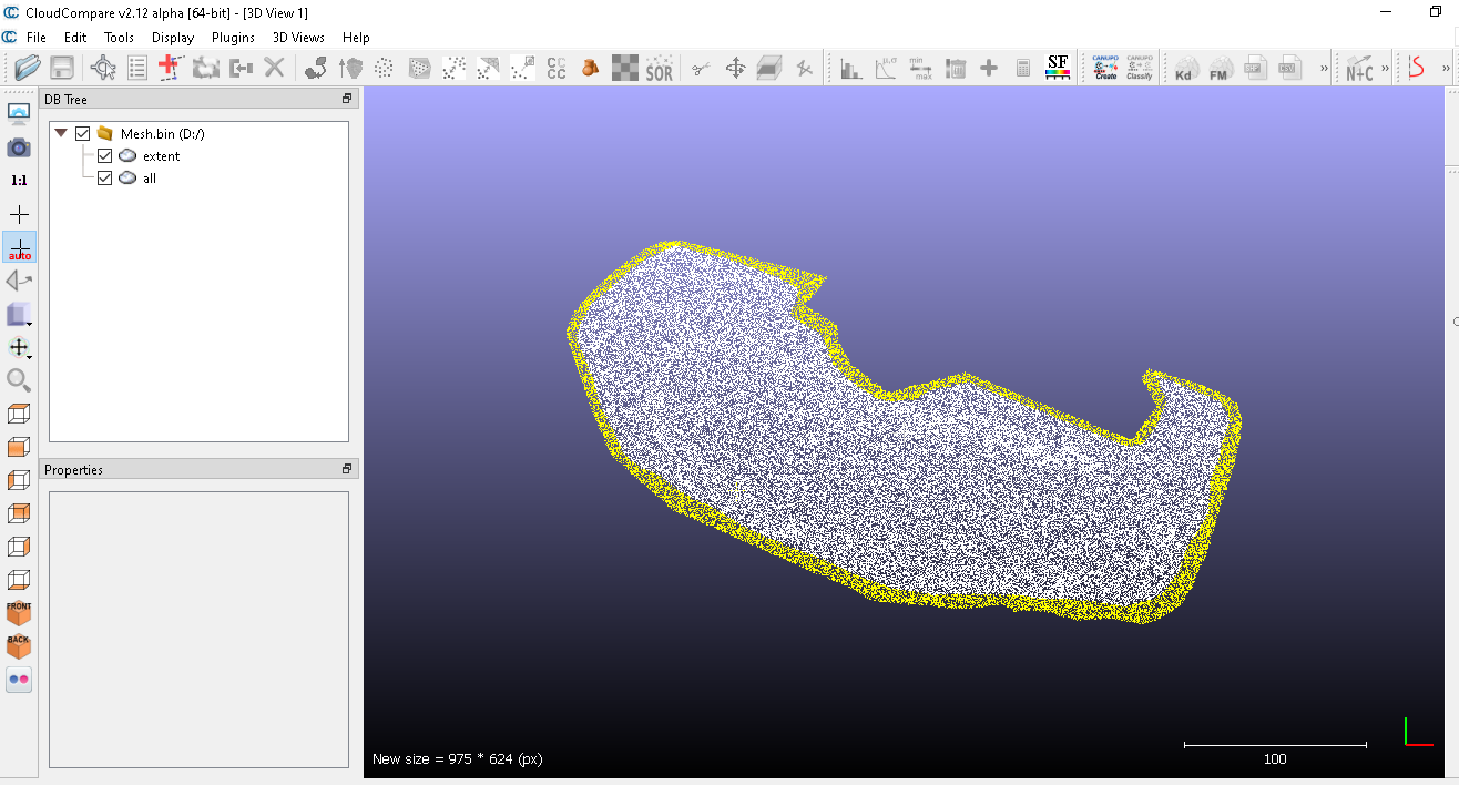

It should not matter if they are not on the same Z level, I think the confusion is terminology, in the cross section tool under extract contours, the thing you are asking for is called "Extract envelope" rather than extract contours.

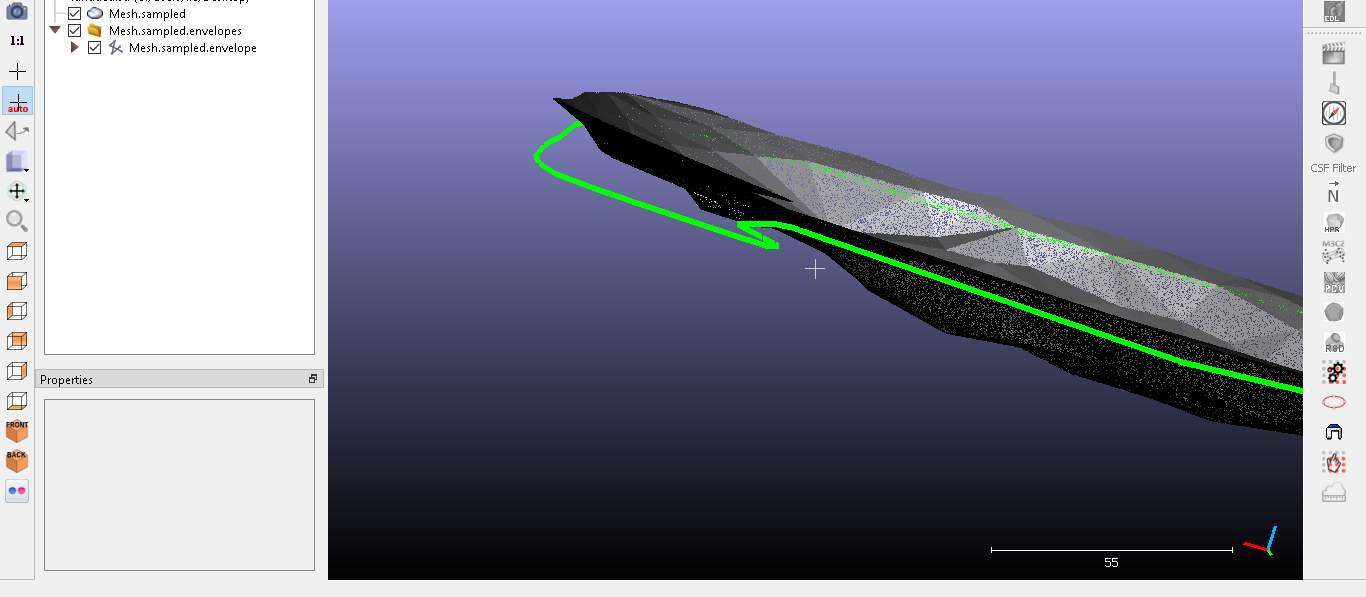

This helps a little but Z values of polyline does not match Z of perimeter of mesh?
XY are OK

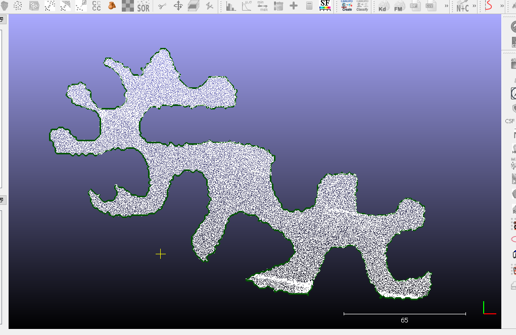

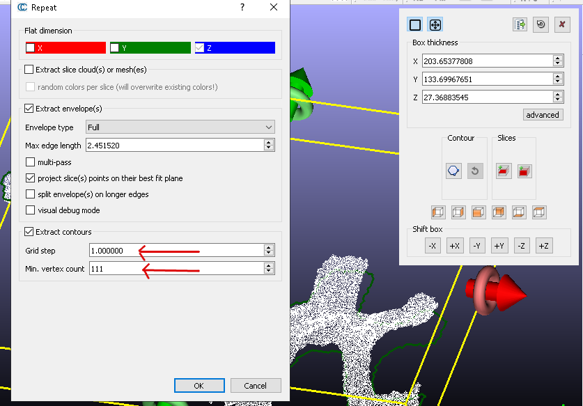

However, I found that polyline contour sometimes is not accurate in xy plane especially if there is big variation in mesh Z
see in image below
But playing with grid step & min. vertex count makes result polyline accurate in xy plane

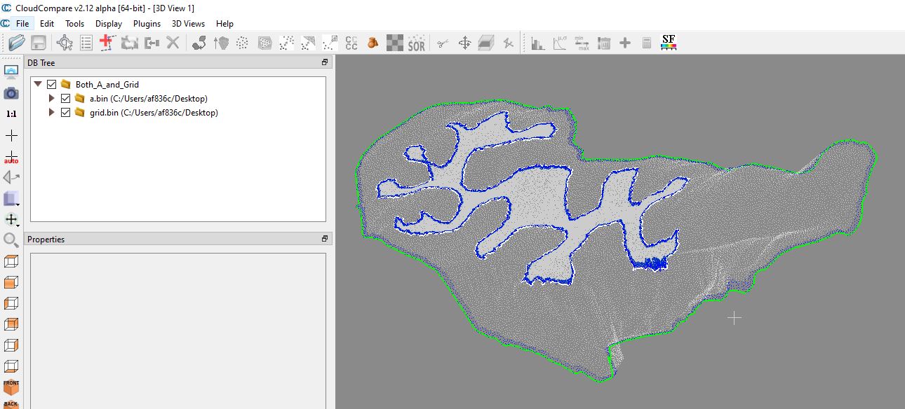

I had good success following what I told you, zeroing out the Z value getting the contours then restoring the Z values. only extra step I didn't mention was to interpolate the original clouds SF values to the vertices of the extracted contours and restore the Z SF to the vertices as well to get the contours to follow up to the original locations.
a.zip
Your example file modified with the method described above
(538.52 KiB) Downloaded 2709 times
