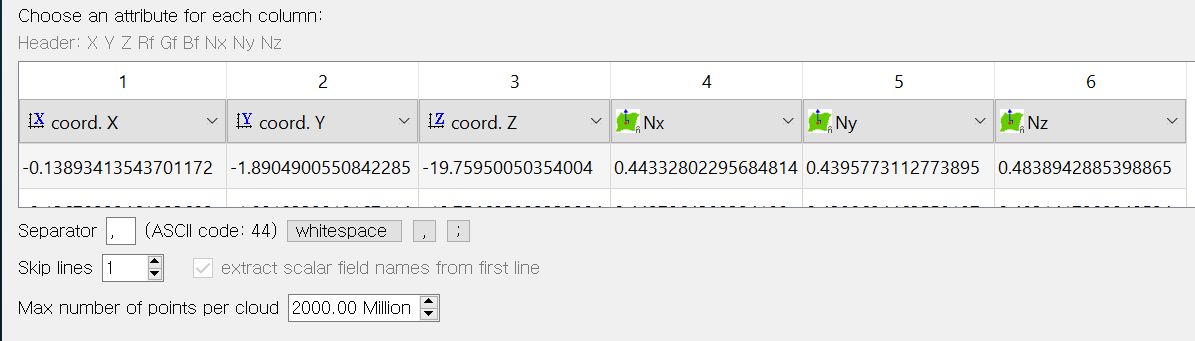

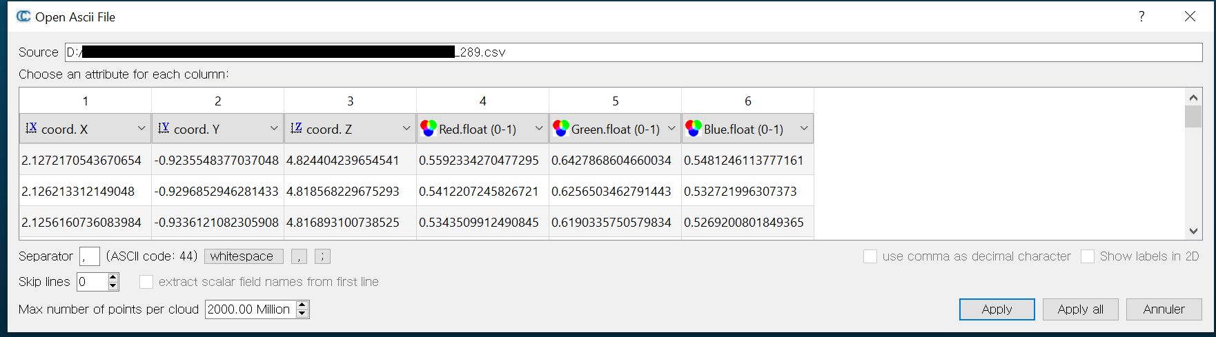

Using CC in Command Line mode, to convert CSV (Ascii) data to PLY (Binary_BE) file format, it seems we can't define the attribute for each column. Those Attribute choice are missing for each column.
Actually i want to define Column like that, but the Color is converted to Normal vector instead:
CloudCompare.exe -SILENT -O D:/CSV/export_0.csv -C_EXPORT_FMT PLY -PLY_EXPORT_FMT BINARY_BE -NO_TIMESTAMP -SAVE_CLOUDS -CLEAR
Is there a solution to this ? Maybe via Python ?

What i want is defining the 4 to 6 Column to be that way once i launch the command line Bat file.
Actually when i use the Command Line, that Popup doesn't show up.
And at the end the Output PLY file is just White . There is no Color saved.
Re: Command Line Attribute choice missing for each column when batch open CSV to PLY.
Ah, float color components... They are generally mixed with normals when CC attempts to automatically detect the role of each column. And if you add the header, it will try to load them as 0-255 color components. I think that's clearly a limitation for now.
