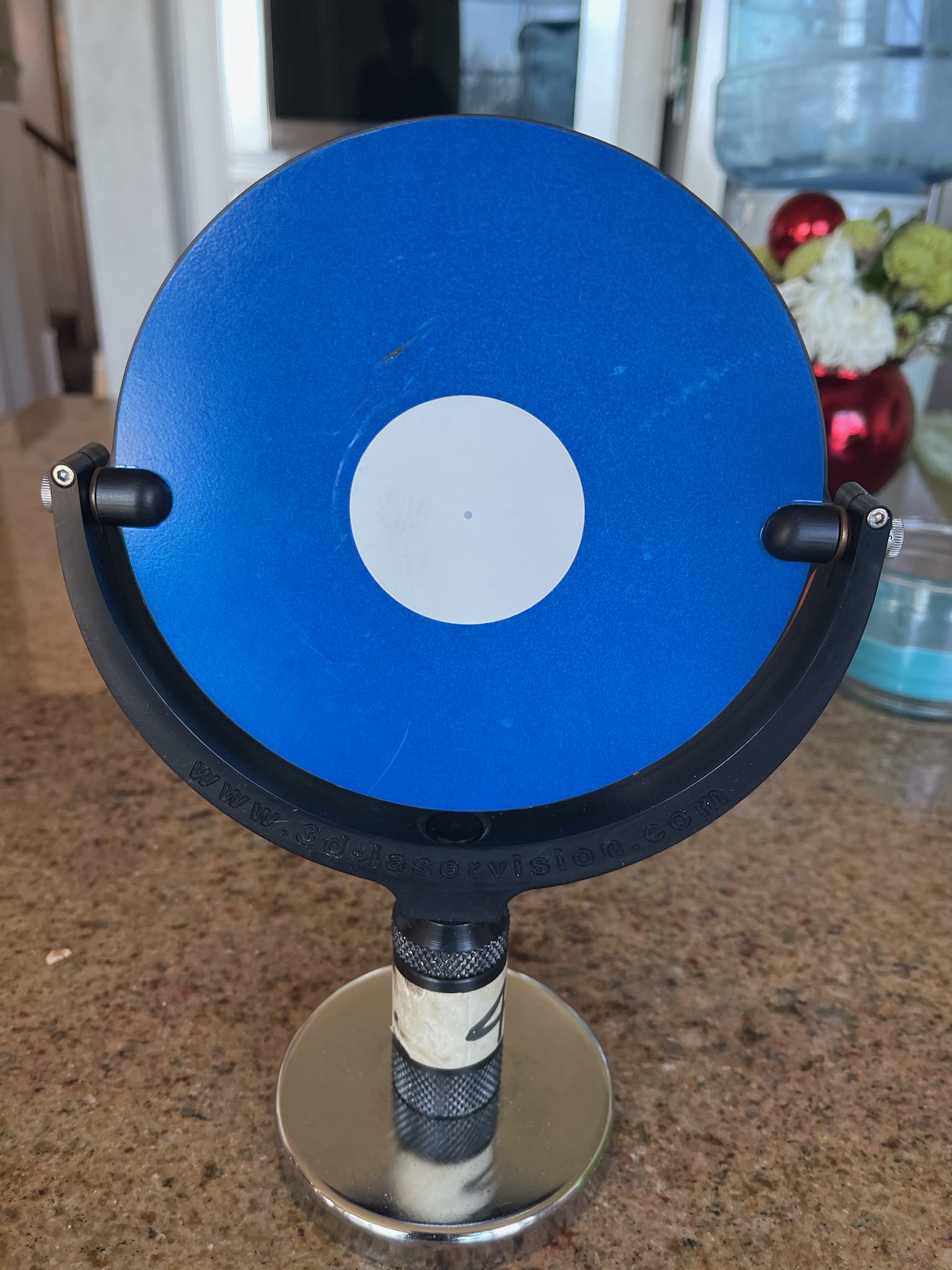

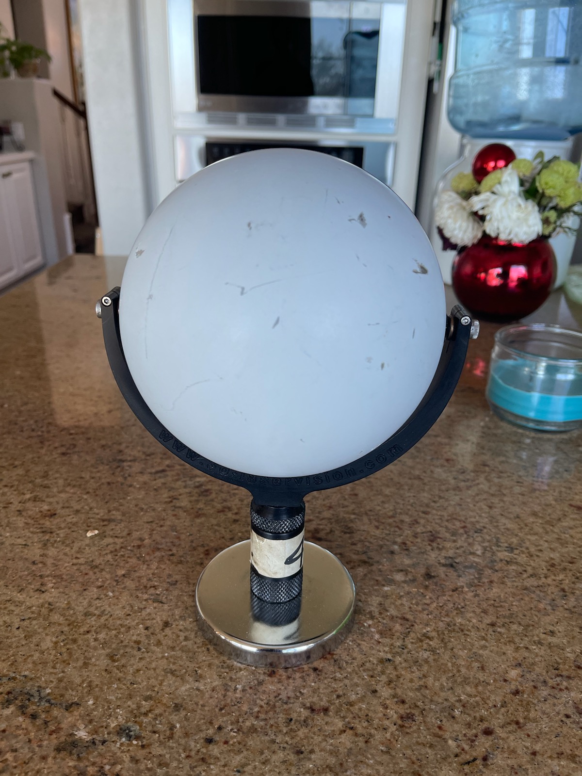

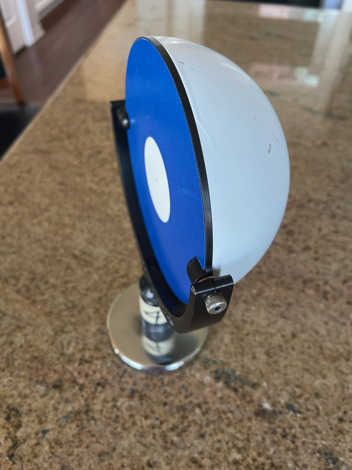

Hello all and thanks for your time. My question involves the use of a specific type of spherical lidar survey target, with the Emesent Hovermap system. Last year, a white paper was released by Emesent detailing a workflow which utilized spherical survey targets in conjunction with the "Best Fit" tool in Cloud Compare.
My question is, can I use the targets in the attached photos, as they are only half spheres, or will the spherical best fit tool only function well with true spheres?
WargodHernandez
Posts: 187
Re: Use of Spherical Targets with Best fit tool for fine registration
Post by WargodHernandez »
You do not need full sphere’s, in fact when scanning from a single PoV there is almost never more than half a sphere captured from most scanners. In the past I have used best alignment across multiple spheres from different sensors and positions with typically <40% of each sphere visible from any one sensor
