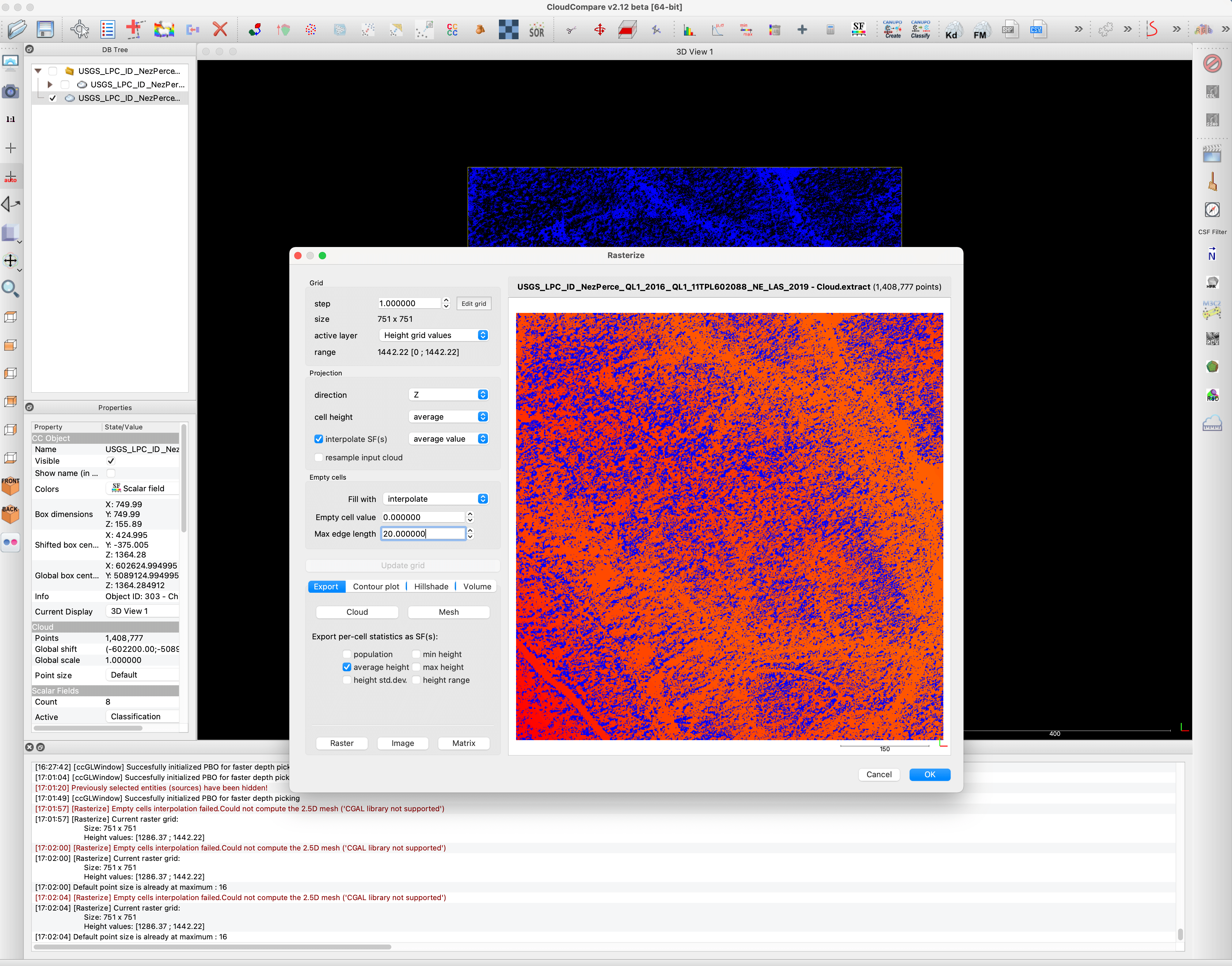

The interpolation function when rasterizing doesn't appear to be working properly on my machine (MacBook Pro w/M1 processor). Raising the "max edge length" has no effect of filling the holes unfortunately. The data I'm using are all ground points.
Here are some images from my end of the process. Any ideas or insight would be much appreciated! I am running version 2.12 beta (macOS 64-bit) of CloudCompare.
Thank you.

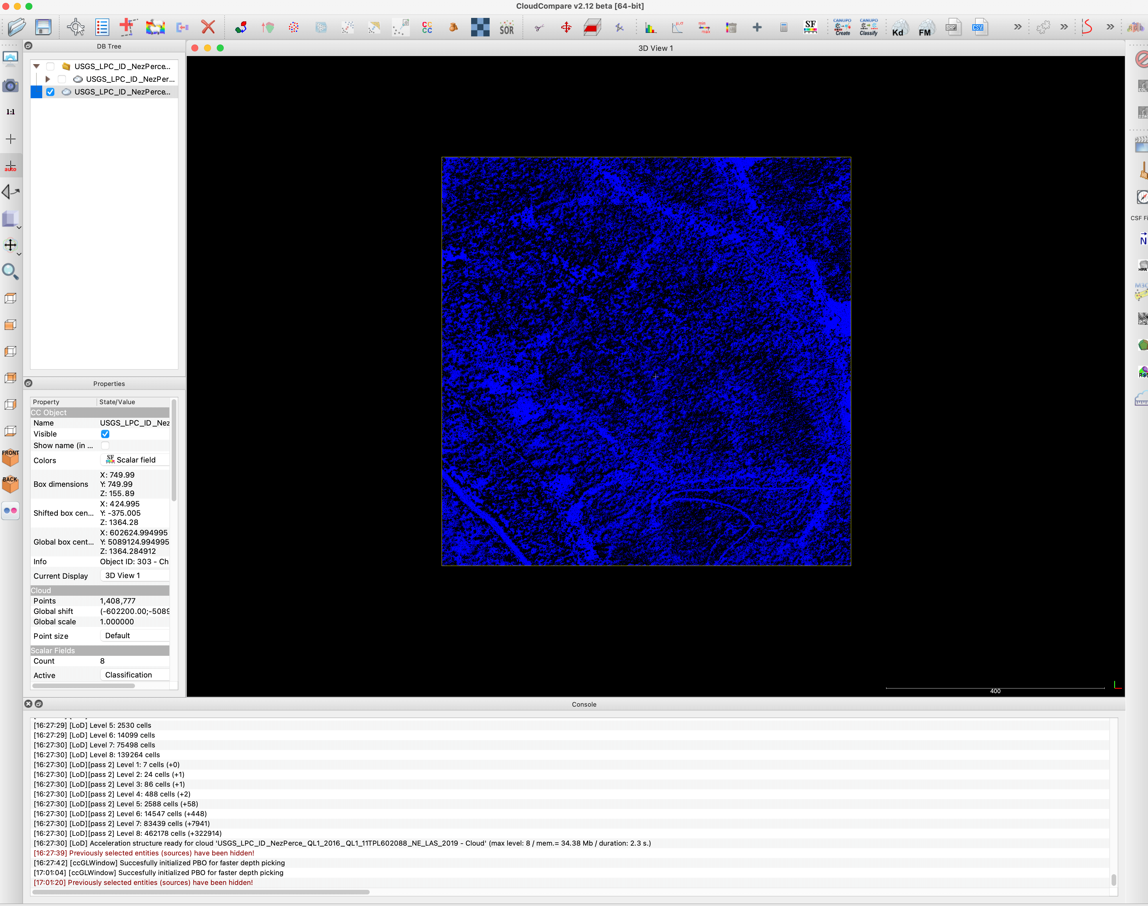

after interpolating attempt
after filtering data to ground points

Ah yes, that's because CGAL is not supported in the current macOS version! Which means we can't triangulate/interpolate the grid points.
