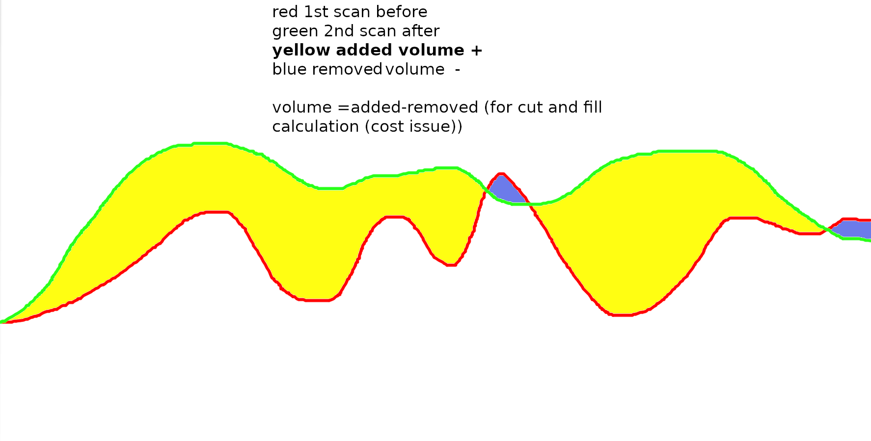

DA523
Posts: 186
Re: Compute 2.5D Volume Report Questions
Post by DA523 »
BIN FILE 2 pointsclouds
13.7z
(1.73 MiB) Downloaded 1317 times
