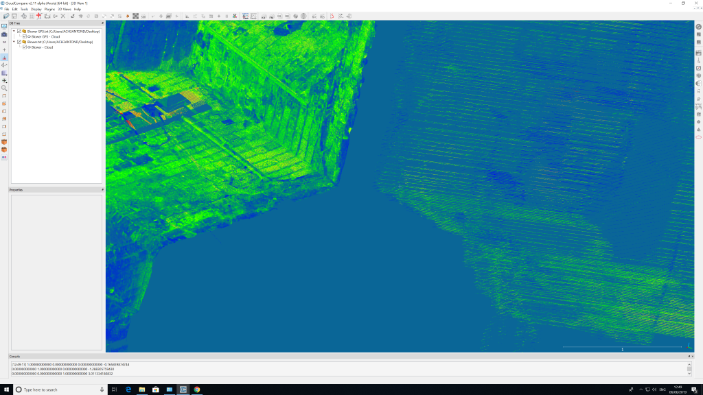

I am currently involved in massive point cloud processing and I decided to use CloudCompare for geo-referencing my scan data.
When applying a transformation matrix to any point cloud (apparently regardless the number of points) using CloudCompare v2.11 Alpha, the quality of the data decreases -the point clouds lose accuracy as in the screenshots attached (they are the same point cloud. Left: original; Right: transformed).
This does not happen when transforming the point cloud with the Translate/Rotate tool.
Thank you so much.

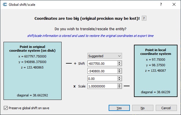

Re: Point cloud accuracy loss after applying transformation matrix
And when you input such a transformation matrix, CC doesn't ask you to apply a Global Shift? (if yes, then you should accept this temporary shift).
Hum, that's weird. On my side, with version 2.12.0, I see:
Can you check that your 'File > Global Shift settings' dialog has the right values? (should be 10^4 for coordinates, and 10^6 for the diagonal).

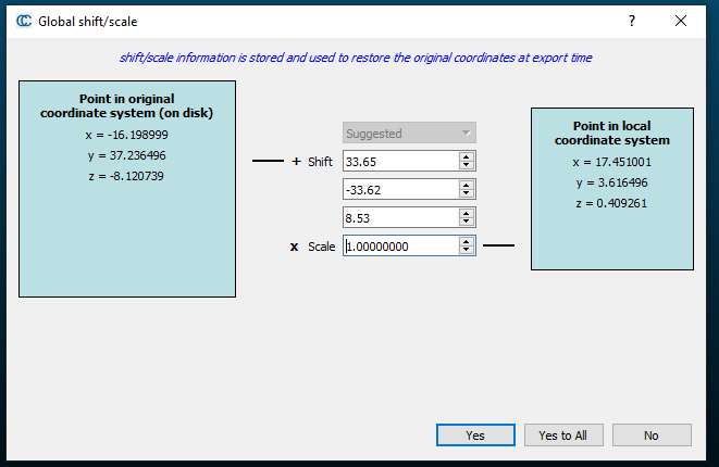

I'll revive this post because i have a similar problem
When importing the point cloud with local coordinates (<1000), due to its size, there is the automated query to apply a global shift to the coordinates. This query is done again after the transformation.
The parameters of these shifts are then, as i understand it, saved and should be attached to the coordinates after export. However, i think there is a processing error when the shift is attached in both processing steps. In this case, CloudCompare uses only the last one applied, which results in incorrect coordinates (my result, maybe someone can verify?)
The option to apply the shift during import and not during the following transformation results in a loss of point density , probably because the translations are very large ? Here i get just the same result then the others, somehow its "rastered" Only if no shift is applied during the import of the locally referenced point cloud, but during the transformation, correct results are obtained. There seems to be some kind of error i Cloud compare cause only the last shift is applied?

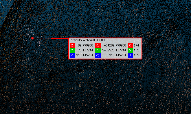

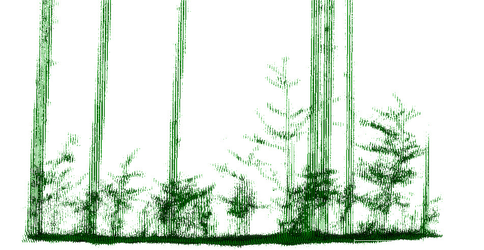

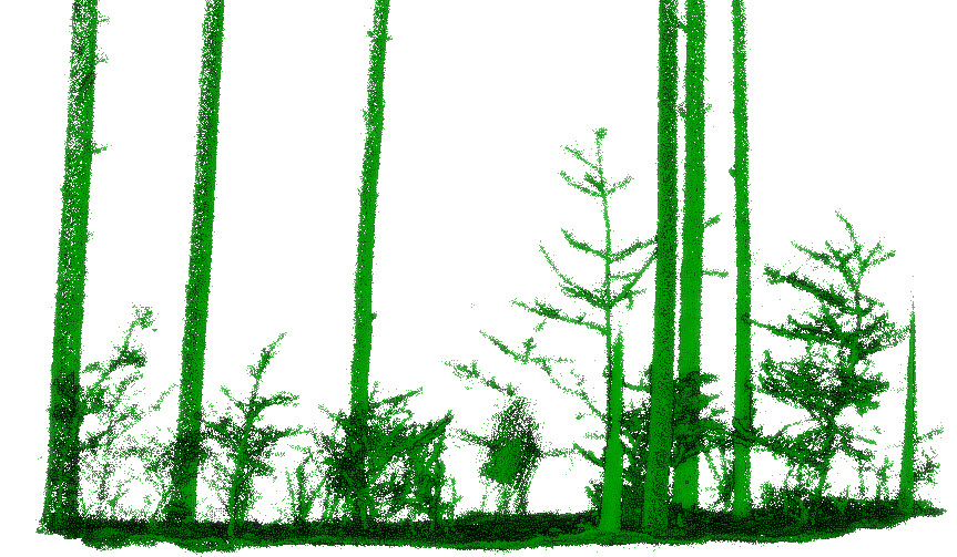

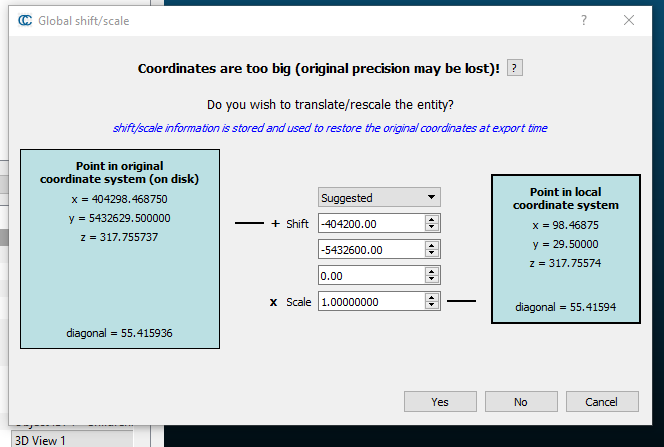

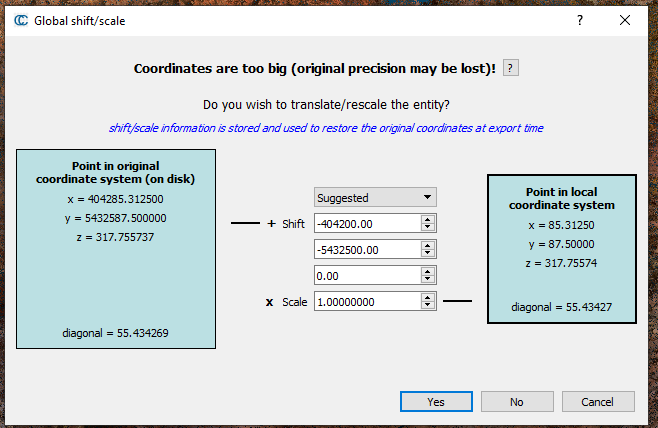

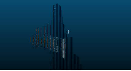

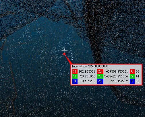

Import shift is the same for both and i press YES then afterwards while applying the transformation there is this option Now there are two cases
1) If i go NO for the transformation shift i get this which is just wrong
2) If i go YES for the Transformation shift i get this result for a random target which coordinates i know which is slightly wrong
as i said, only NO for the shift at the beginning(first picture) and yes at transformation right here gives a good result
correct result
Hope this was understandable
Thank you for your help
