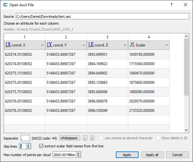

In the 'ASCII file' loading dialog, you can check and change the role of each column.
But on my side the roles are properly assigned (with the 2.13.alpha version at least):

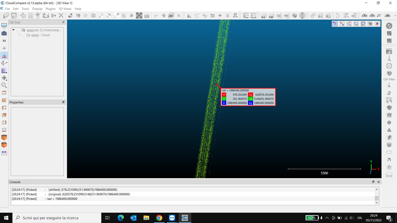

thank you for your interest. I gave a try also on the 2.13 but the result is the same: a correct importation (like the screenshot you showed) but a wrong cloud generation. If you pick the information of a single point the weird thing is that the scalar value is duplicated both on the scalar field and Z (see attachment)...
