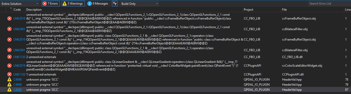

Since it appeared that the build was still searching for qLASFWFIO, I set -DPLUGIN_IO_QLAS_FWF=OFF and got a successful cmake. But building in Visual Studio 2019 resulted in 7 errors:
Screenshot 2022-10-24 112217.png (63.74 KiB) Viewed 7715 times
