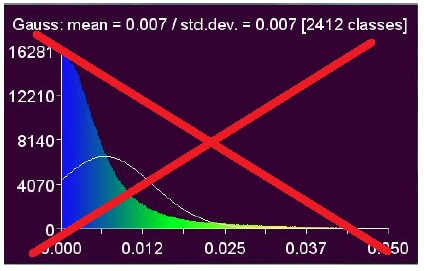

  • Speaking of global statistics, please mind that the output of the Cloud-to-cloud distance computation tool is unsigned (i.e. no negative values). So there's absolutely no chance that the result follows a Normal Distribution. Sometimes the error/deformation/etc. you are measuring does follow a Normal distribution, but even in this (ideal) case the output unsigned scalar field follows a Folded Normal Distribution (http://en.wikipedia.org/wiki/Folded_normal_distribution).
The 'Edit > Scalar Fields > Compute Stat. Params' tool doesn't take this into account. It simply and blindly fits a Normal distribution to the current scalar field (a future version will let the user specify if the scalar field is folded or not).
But in any case (and this is a more general consideration, not only applicable to CloudCompare output) if your samples don't follow a Normal distribution, first you can clearly visualize that the theoretical Normal distribution doesn't fit well... and then you have to ask yourself if the corresponding parameters (mean values, standard deviation, etc.) have any meaning at all?
Waiting for a proper mean to compute the 'Folded Normal Distribution' parameters:
