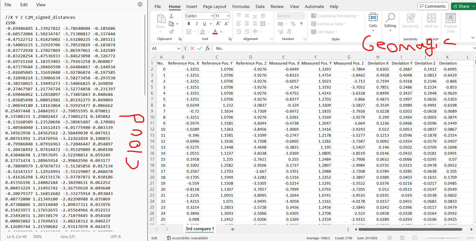

Are you able to export per-point distances with Geomagic?
Re: Inquiry Regarding Discrepancies in Mesh Comparison Results Between CloudCompare and Geomagic Control X
yes
(refer the attachments)

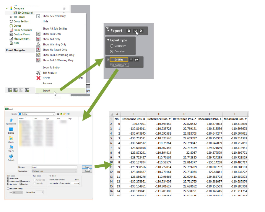

You can review the calculation methods used in Geomagic by following this link.
https://support.3dsystems.com/s/article ... uage=en_US
- Screenshot 2023-12-18 233508.png (221.74 KiB) Viewed 25093 times
- Screenshot 2023-12-18 223501.png (421.9 KiB) Viewed 25111 times

Si I saw the link, but it's not super clear how they manage the cases when the projection of the point on a triangle falls outside of the triangle (and potentially outside of any triangle). Similarly to MeshLab, we use the algorithm defined in the old 'Metro' tool (https://github.com/cnr-isti-vclab/vcgli ... apps/metro) or alternatively by 'Geometric tools' (see https://www.geometrictools.com/Document ... angle3.pdf). Basically, we use the distance to the closest edge or the closest vertex.
If geomagic is following a different approach, this may explain the differences.
Can you export the two clouds (with their respective distances) and share them with me? (admin@cloudcompare.org). Or you can also load both in CC, interpolate the scalar field of one onto the other (make sure they have different names), and then compare the 2 scalar fields with the 'SF Arithmetic' tool. This may help us to visualise the differences, and if they are in specific parts of the mesh.
