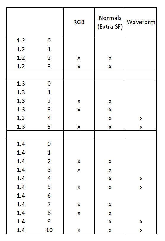

hello Daniel,
you are right! Depending on the version of the LAS file the different options are activated, in particular I was getting the default version 1.4 sub 6 which doesn't allow colour and extra field, changing to sub 7 works. I attach if needed for other users the complete table for colour, extrafield, waveform support.
Many thanks
