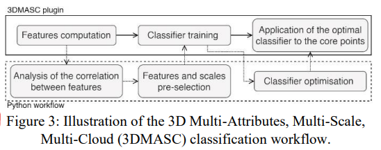

Also in the article, the figure 3 illustrates the classification workflow : there are a 3DMASC Plugin workflow and an additionnal python workflow. Does calling the training by command line enable the python workflow ?
If not, how do you do to use this workflow ?

I would like to use the whole workflow (Features computation, Analysis of the correlation between features, Features and scales pre-selection, Classifier training, Classifier optimisation, Application of the optimal classifier to the core points).
From my understanding of the article, I need to use the « Features computation » by command line (« 3DMASC can be called through command line solely for fast feature computation. »). Can you help me to specify the command ? I guess it should be something like : CloudCompare –O « pointcloud.las » -3DMASC_CLASSIFY « classifier.txt » -ONLY_FEATURES
The output of this command can then be used for the « Analysis of the correlation between features ». There again how can I use it ? I’ve looked through the python code but it isn’t obvious to me which function to call.
I have the same question of which function to call for the « Features ans scales pre-selection » step.
Then for the « Classifier training », I suppose I should use the parameters file created from the previous steps and my point cloud and call it using the command line. What would be the command line for this step ?
Then again, how can I run the « Classifier optimisation » ?
To sum up, I would definetly need some hints to use the full classification workflows.
workflow 3DMASC.png (72.38 KiB) Viewed 122976 times
