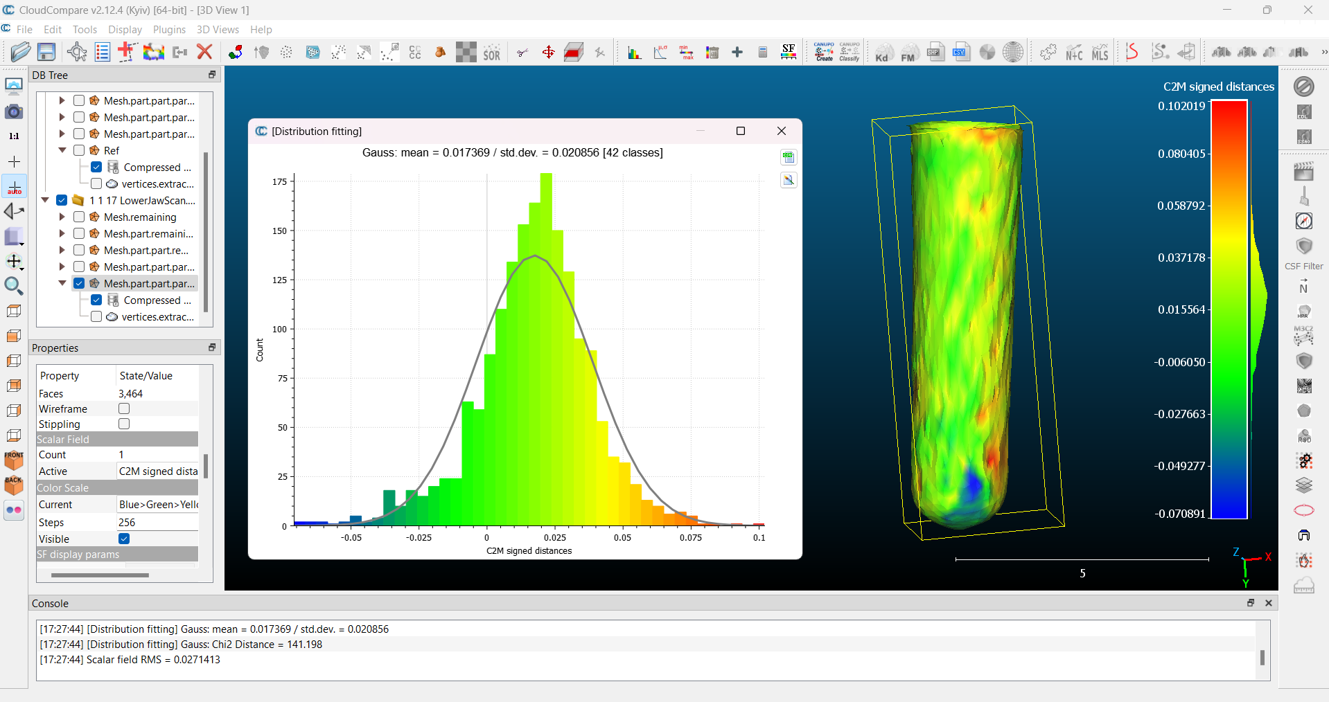

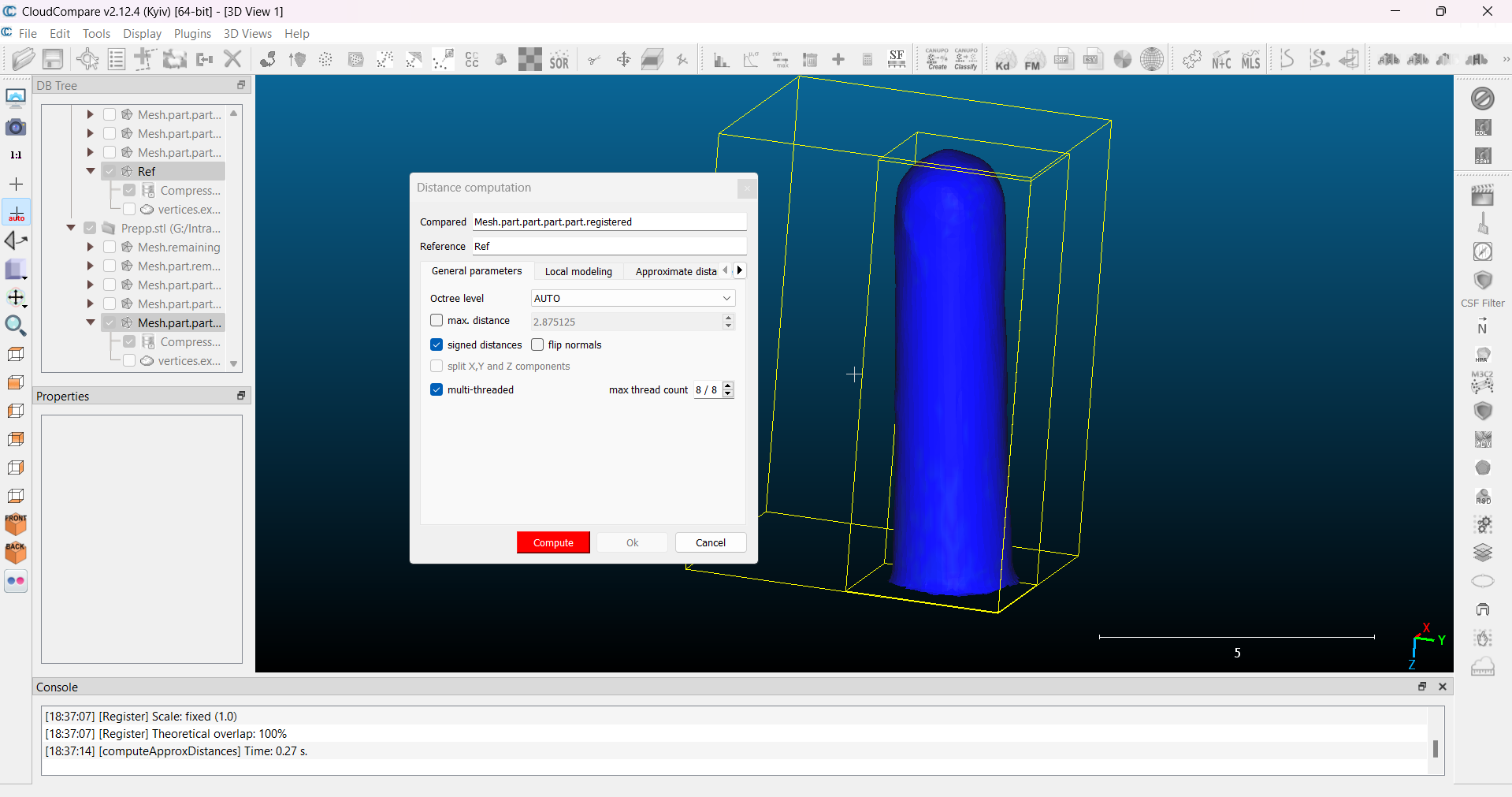

I am currently engaged in my research, where I have segmented two files for superimposition. However, upon selecting these segmented files for the C2M process, I have encountered a recurring issue, the source of which remains unknown to me ( Photos 1 AND 2)
Interestingly, I have executed identical steps with other samples without encountering this problem (photo 3). (I have ensured proper selection of both the reference and control files.)
Re: displaying a single color on the scaler field
It is not clear to me what the problem is exactly, but I would guess that there's one point that has a totally different distance from the rest.
This make me thing about a 'limitation' of the C2M that was fixed recently in version 2.13.1 version. Can you test with this new version and report here if this fixes your issue or not?

Thank you, Mr. Daniel,
I had to remove some points that were distant from the model, but after doing so, it worked.
