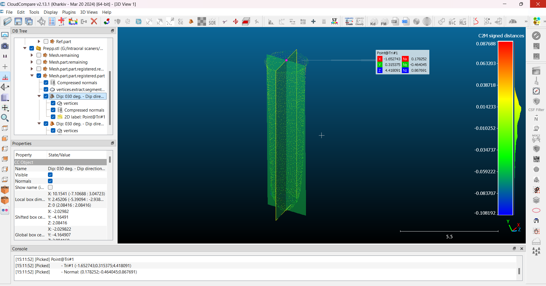

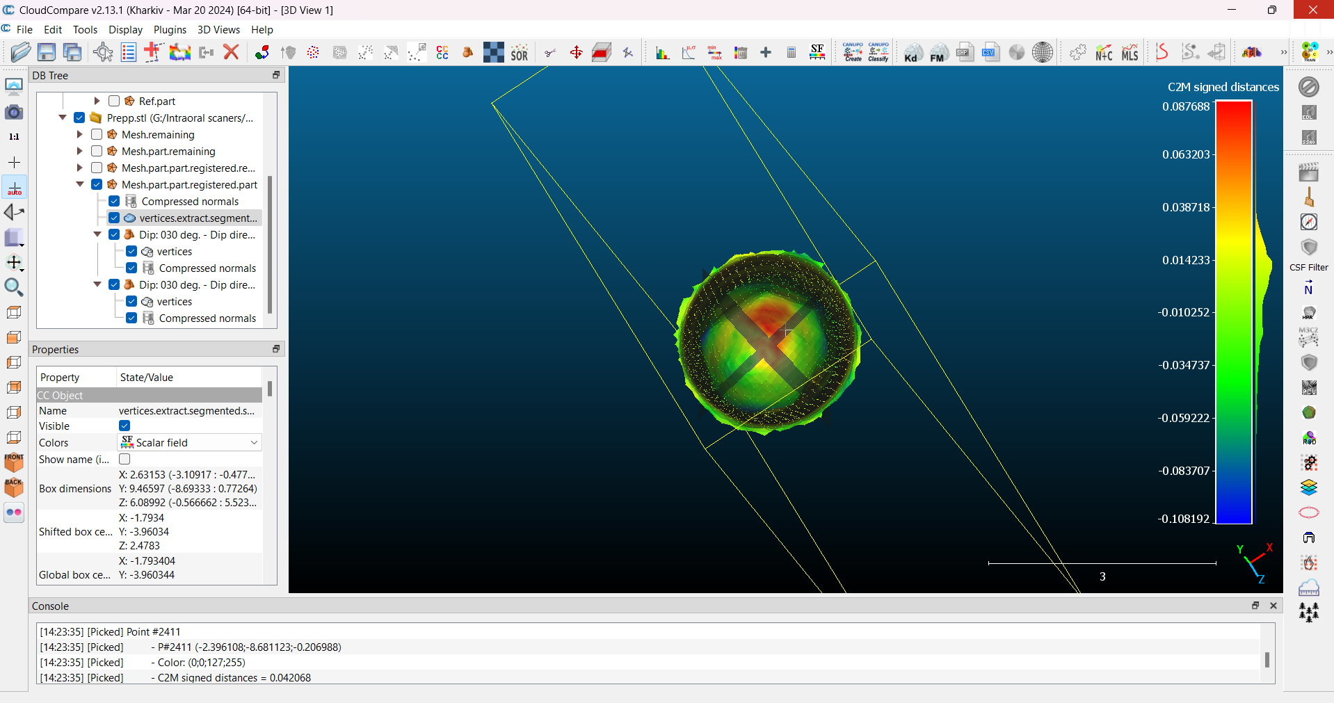

Hello, Mr. Daniel, I trust you're doing well.
I've established two perpendicular planes aligned with the C2M distances. Now, I aim to select multiple points on the plane created to enhance the precision of vertical distance measurements because my cloud has a cylinder shape.
I attempted to select various points named Point @Tri 0 and 1. Occasionally, the selection process succeeds, but other times it fails (keeping my selection as a rotation center, as depicted in the attached image).
My query is, how can I select numerous points on the plane, unrestricted by the cloud, for my measurements?
2 planes fitted on the C2M signed distances 1.png (221.4 KiB) Viewed 3257 times
When trying to slect other point on the plane.png (187.2 KiB) Viewed 3257 times
2 planes fitted on the C2M signed distances.png (300.35 KiB) Viewed 3257 times
Re: Picking points on the fitted plane
Can you simply hide the cloud? (or did I misunderstand your question?).
Also, you might be interested in using the 'Point list picking' tool if you want to select multiple points on a particular entity.
