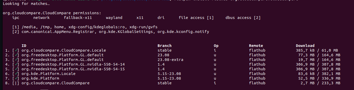

Here's my config:

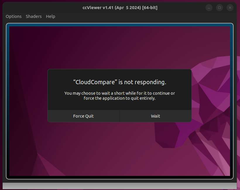

Everything is great during the installation, when i launch the software (Cloudcompare or CloudCompareViewer) and do nothing, it is working, but when i try to turn around on the 3d visualization, the viewer began to be black and then i have the pop-up 'Cloudcompare is not responding'

Do you have any idea why? I suppose this is related with my drivers, OS, or graphical lib because this is a basic feature, but i can't find it. When i try to launch it from command line i have this :
$ flatpak run org.cloudcompare.CloudCompare
QSocketNotifier: Can only be used with threads started with QThread
qt.qpa.qgnomeplatform: Could not find color scheme  ""
libEGL warning: egl: failed to create dri2 screen
libpng warning: iCCP: known incorrect sRGB profile
qt.gui.icc: fromIccProfile: failed minimal tag size sanity
QPngHandler: Failed to parse ICC profile
Language not found for translation file "CloudCompare_chs.qm"
Any help or suggestions would be greatly appreciated.

Solved by changing from Wayland to X11.
