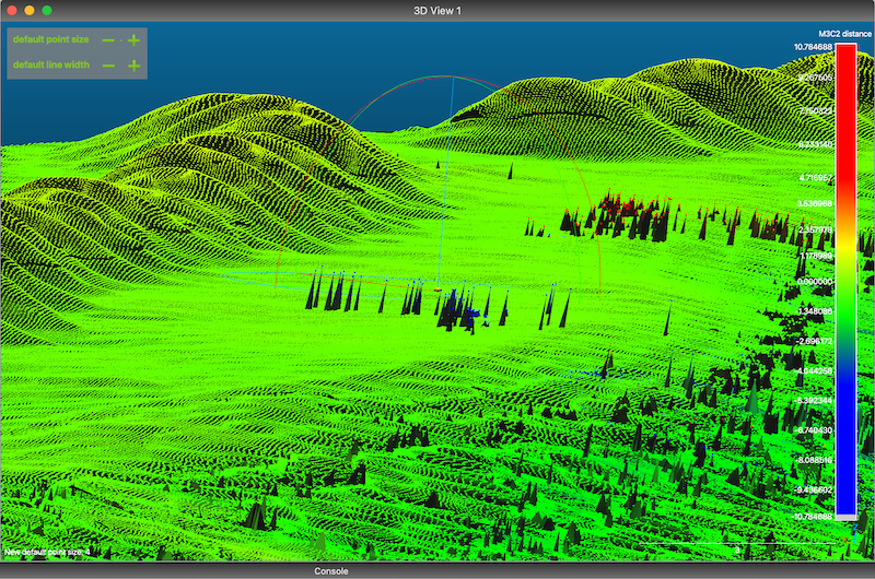

I am subtracting two point clouds and am finding some extreme errors in my M3C2 subtraction where there are no points located in the original point clouds.
Here is the M3C2 difference between the two clouds. This projection is using the mesh 2.5D best fit with 1m max edge length to visualize the error.
As you can see there are the pinnacles of red and blue which are a difference of more than 5m (impossible at that spot).
Screenshot 2024-06-11 at 12.01.02 PM.png (923.48 KiB) Viewed 3639 times
As you can see from the point cloud, that there are no points in those areas to create that pinnacle. First is the baseline, the next is baseline overlaid with M3C2

Sorry, I'm confused: what do you mean by subtracting? Due to how M3C2 works, the 'pinnacle' points are necessarily coming from the original cloud (and from the same cloud as the other points). Isn't it simply noise?

Sorry, subtracting is the wrong term with M3C2, but calculating the difference between two clouds. How do you limit the noise? Is there a step in running M3C2 that I can take? I have tried increasing the diameter of the normals and projection but I get the same thing.
Re: Subtraction Errors found in M3C2
So the easiest is to use the 'Tools > Clean > SOR' filter. Or, the scissors tool and do it manually?
