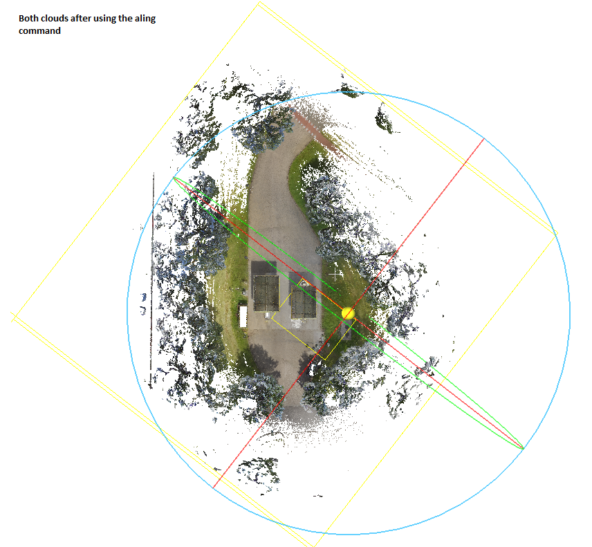

I tried both options on the Iphone cloud. but it did not work.
i also tried it on another cloud that was not made with the Iphone. and that worked great.
