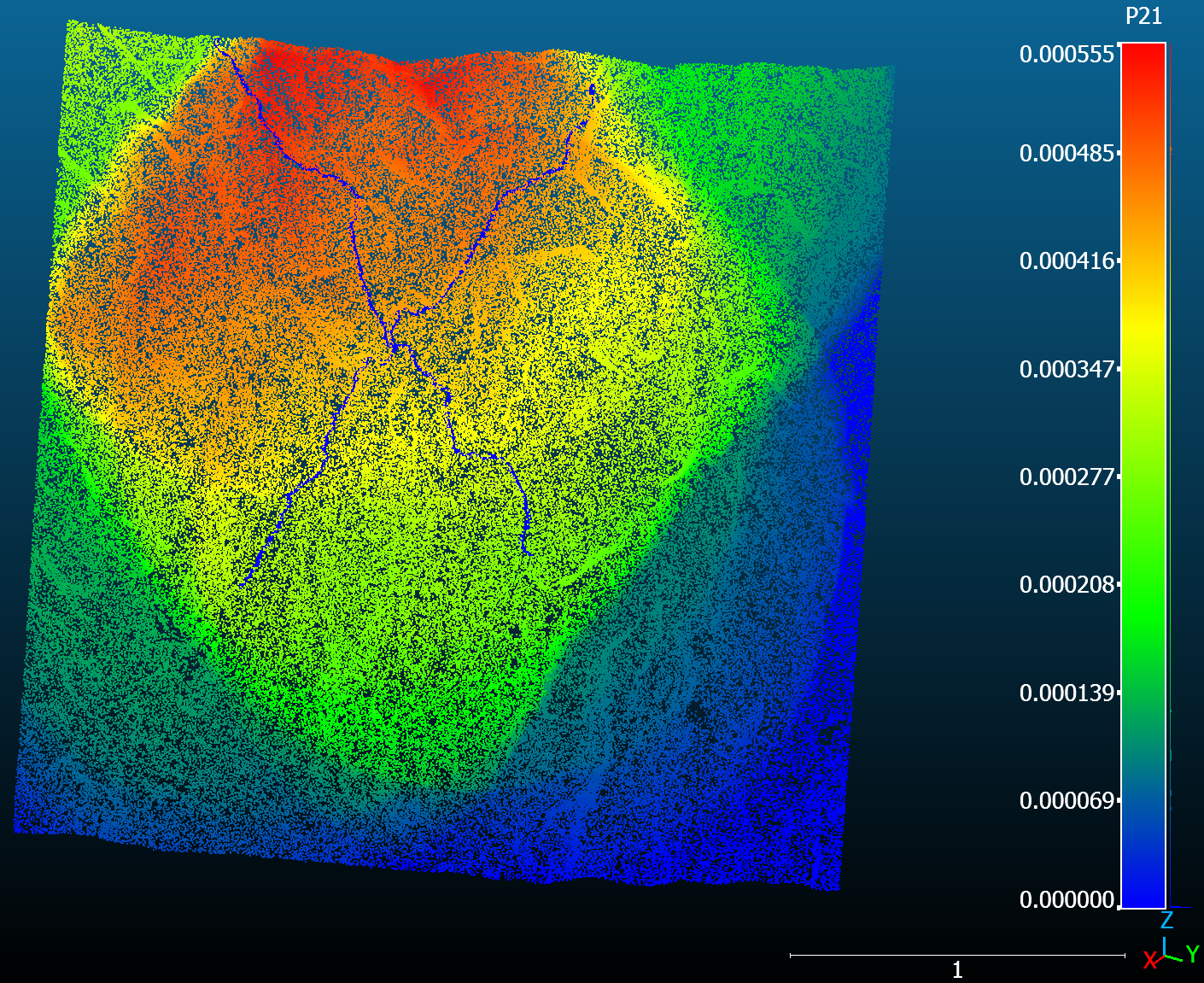

Good afternoon!
I am calculating P21 fracture intensity from a dense cloud obtained from a UAV survey of a slope. According to sources P21 = sum of crack lengths/wall area. For the experiment, I took a wall fragment of 2.5 x 2.5 meters (area 6.25 square meters). I drew 2 cracks with the help of compass plugin, total length 4.9 meters. Therefore, P21 should be equal to 4.9/6.25 = 0.78. However, when calculating P21 in the compass plugin, the values are about 0.0003 (see the file in the attachment). What is the error?
Example of P21 calculation in the compass plugin
Re: P21 fracture intensity is incorrectly calculated in the compass plugin
I think it would be better to ask the author directly (Sam Thiele).
Maybe reading the code might help as well: https://github.com/CloudCompare/CloudCo ... .cpp#L2737

Thanks, Daniel, but how can I get in touch with him?
There's a contact section on his personal website: https://www.samthiele.science/ (at the bottom)
I'll update the wiki as well!
