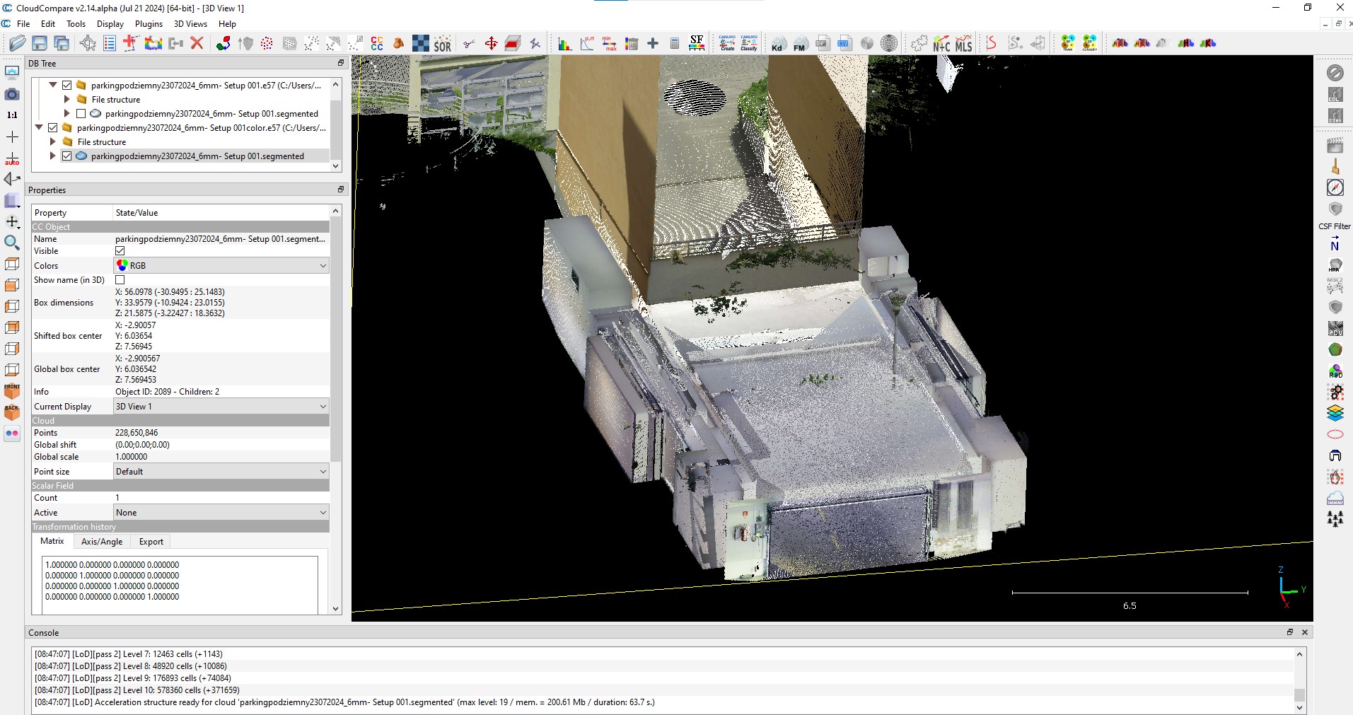

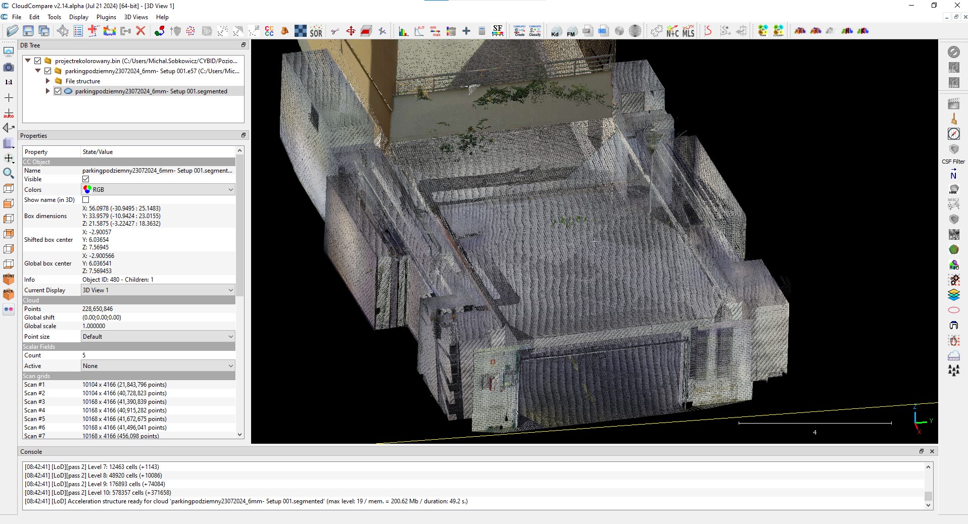

CybidMS
Joined: Wed Aug 07, 2024 9:46 am
Re: Removing points from overlapping scans by specific scans
Post by CybidMS »
After using 'Edit > Colors > From Scalar fields' tool I receive colors I want (mix of all my scans),
then I save it to e57, once I open it again, the view of RGB changes to the beggining.
And did you say you were able to use an alpha component for the colors? Because I don't think it is saved in the RGB field of the E57 file (not even sure this is supported by the E57 format).
