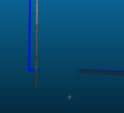

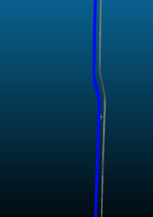

I have two separate mobile scans collected with an Amberg trolley equipped with IMU and ZF 9012.
Each run was processed independently, and now I would like to merge both point clouds into a single cloud.
The scans align best at the fixpoints, but in the sections between the fixpoints, there is a visible drift and mismatch between the clouds — typical for IMU-based systems.
Therefore I would need a scale or stretching option along the trajectory to compensate for the IMU drift.
I know that Cyclone only supports best-fit (rigid) transformations, without any scaling.
My question is:
Is there any way in CloudCompare to perform a cloud-to-cloud alignment that includes scaling (similar to a 7-parameter Helmert transform)?
Any advice or experience with similar Amberg or mobile datasets would be greatly appreciated!

Well, you can use the 'adjust scale' option both in the ICP and point-pair based alignment tools. But that's not along a particular direction, but maybe that's sufficient.
