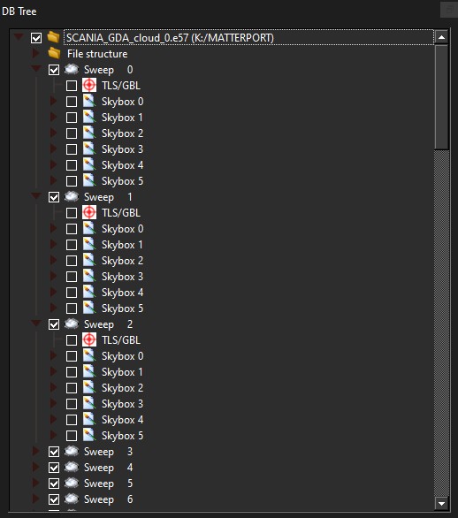

I think CC lacks some bulk selection / filtering tools.
My case is that I imported E57 structured point cloud, acquired with a Matterport scanner, containing over a 100 separate scans, each shipped with multiple images, making up a skybox. AFAIK, merging the scans into one cloud requires deleting the images first (unless there's another way - in that case, please teach me :P)
Though it's a little daunting - deleting hundreds of images manually for each job. They are nested under each cloud entity, not listed separately in the DB Tree, so it's not so quick to dig and erase them.
Adding s screenshot of how they look in the DB Tree.
My idea is to introduce a tool to select all entities by type, or sort / filter the DB Tree by entity type. That would make selection and further bulk actions (e.g. deletion) much easier.
We have multiple types of entities in CC: cloud, mesh, image (and probably more, that I'm not aware of), so I believe this would make sense.

If you right click on any DB tree entry, you just need to select 'Select children by type/and or name' and then choose 'Image' as the type to select.
