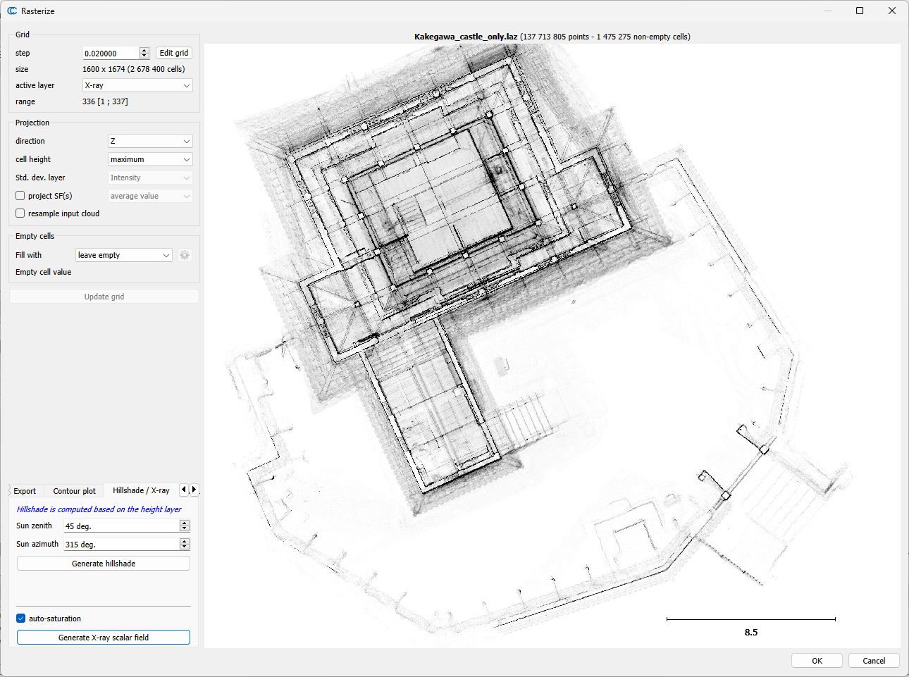

So it was quite some time that I wanted to play with this idea.
I took a stab at it in the 'Rasterize' tool which is indeed the easiest way to do it for now.
I added a 'X-ray' option to the existing 'Hillshade' tab at the bottom left of the Rasterize tool window (now called 'Hillshade / X-ray').
It will create a scalar field with the accumulation value. You can then export the grid as a cloud if you want more rendering options (tweak the color scale, use the 'Display > Render to file' option, etc.).
You can test this in the latest 2.14.alpha version for Windows

great - thanks for putting this xray feature in the next release / current beta.
I did grab the latest code and managed to get the xray view coming up in the preview in Raster dialog...
and it says its generated a new scalar field xray ..
BUT, I didnt seem to be able to save that as an image ?
g

ok.. so it generates a new cloud with the xray 'height' .. then you rasterize that new cloud to get the ortho-image ?
That seemed to give the desired output.

Hi there, just discovered the X-ray tool introduced in this PR, nice one! It could be useful to add a quick reference in the doc just so users know it exists without having to test the raster projection tool.
The way we achieved such an xray result in the past was simply exporting the density (population per cell), and either style the scalar field (ptc exported) within CC scalar field editor, or for finer control, import into QGIS and edit Symbology. Using Qgis is also useful to apply image processing like Laplacian, to better handle multi-resolution pointclouds.
My understanding looking at the current implementation is that the grid XY cell-width is used to make a voxel 3d-grid (extending in the projection direction), with one layer spanning each cell width. The projection therefore only accounts for one layer for density higher than that that cell-width, which is a nice idea. The saturation = mu + 2.5 * sigma is also a nice found default.
Just for reference, this method might not be enough for pointclouds with disparate resolutions (like merging focus photogrammetric 3D scan 5mm low area, with landcape 5cm GSD). What we did to tackle such Xrays was first-pass, compute a somewhat accurate density estimate (counting points in neighborhood, hierarchically, at various scales, and computing first meaningful surface density), and then aggregate an inverse function of this density. This is heavier, but once the densities are computed, this might be done similar to how you do it now. Nice to see this land within CC anyway, congrats as always!

Good point, I've added something to the 'Rasterize' tool wiki (https://www.cloudcompare.org/doc/wiki/i ... de_/_X-ray).
(I also fixed the nice typo on the line pointed by your link to the code :-D).
And the good thing about the automatic saturation is that it's only the default Scalar Field display saturation value, so the user can change it manually after exporting the cloud.
