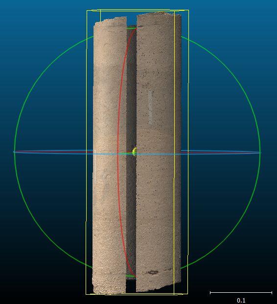

From your posts I got ideas and I found a trick that does the job. You need to cut a vertical band of the core (cylinder) in order to unclose the mesh. The location of the cut is important, so make different tries to find the good one.
For our needs this will be good enough even if it's a little tricky.
Here are screenshots of the cutted core and the unrolled result.
