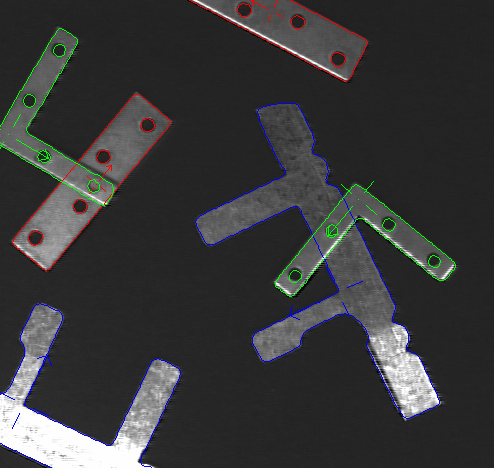

What I want to do is like below:
How can I match the two cloudpoints one is model and one is multiple models.I just want to match the model cloudpoints to one part of the multiple models cloudponits;

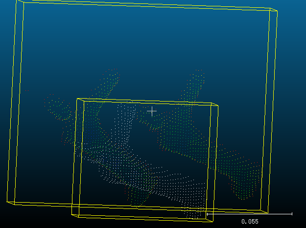

Sorry for the picture,I have upload the picture again.
Thanks a lot for your help.Maybe I haven't understand the 'overlap' parameter.That I can't do a good registration.
the picture I want is like this:
2D_pic
2D_pic
3D_pic
3D_pic
I hope the model cloudpoints can match the one part of the part cloudpoints.(the model is in White color,the part is in RGB color)

Ok, the white point cloud should be totally able to fit one of the "parts". Either you have to use the white cloud as 'data' cloud and the parts as 'model' (sorry, those are the denominations of the original algorithm ;). In this case the overlap is 100%. Otherwise you can use the white cloud as 'model' (won't move) and the parts as 'data' cloud. In this case the overlap is visibly around 50%.
But in both case, you have to roughly register the white cloud first. ICP is a registration refinement algorithm, clouds must be already relatively well registered (especially in this case where both "parts" could fit the white cloud and there's not much points).
