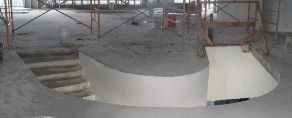

Is it possible to perform an unroll projection on a parabolic shape? Looking at the image I can see that it could possibly be developed in three parts but was wondering if there is an easier way?

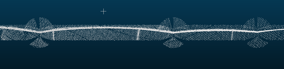

Unrolled Stair using your new tool. Excellent!
Re: Unroll - Parabolic
AH! Nice indeed ;)
Thanks for the feedback!

Note of caution when when using this tool. My procedure was to trace the polyline in autocad and import to cloud compare. If using curves in your polyline the tool extracts based on the chord of the curve (2nd image). If greater accuracy is required as in my case instead of using curves I just loaded the polyline with more vertices (no curves) to create a more accurate elevation view (first image). Thanks again!

Autcad polyline created with arc sub-command. Upon closer inspection it gets imported as chords at the begin and end of the curves. I have sent an email with the dxf and resulting .bin file
